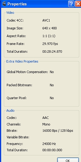

  10. I used AVIDemux to try to post a 30 second sample. This sample plays perfectly in Media Player Classic Home Cinema, but still has an audio problem with DVDFlick. The audio plays way too slow. The 30 second sample should make it easy to try other DVD converters. I have attached a screenshot of the clip info from AVIDemux.

  12. It sounds to me like the audio in the original file is probably not the problem. My guess is that your video has a framerate that is not compliant with any DVD standard. Most of the programs I've seen will attempt to just convert the framerate, potentially at the cost of some loss of motion smoothness. However, it seems to me that perhaps your programs are attempting to preserve the motion smoothness, by simply speeding up or slowing down the video, and then doing likewise for the audio to maintain synchronization, resulting in cr@p audio. Boy, I'd much rather have jerky video, anyday.
    If you could open the file in MediaInfo, as suggested above, that might help. Also, where do you live? Do you live in a country that uses NTSC signals? Or how about somewhere that uses PAL? SECAM? Depending on what TV standards/signals are used where you live, you might need 29.970 (in such cases 23.976 may be used), 25, or whatever SECAM uses.

    @ jimdagys: the sample you uploaded contains HE-AACv2 (aka "parametric stereo").
    Suggestion: first, demux with ffmpeg to an audio-only MP4, and then, decode with faad or NeroAacDec.

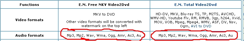

  15. Problem solved. I used Avidemux on the original file to change the audio from the original AAC to AC3 (see screenshot 2). I then fed the file into DVDFlick and had no problem. I didn't try the suggested mkv to DVD converter
    http://www.effectmatrix.com/Free-MKV-DVD/index.htm
    because AAC wasn't listed as permissible audio (see screenshot 1)
    Thanks for all the suggestions which helped me solve the problem.

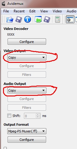

  17. For that matter you could have done the entire conversion in AviDemux. Select the MPeg PS muxer. Then use any free authoring program like DVDAuthorGui to create the VIDEO_TS structure from the .mpg file.

  18. Miles Ahead,
    Could you please complete your answer and tell me what settings for Video Output and Audio Output (see screenshot), assuming I am using the original mkv/AVC1/AAC file that needs to be converted before using DVDAuthorGui. I like to have a few different ways to do the same thing.

  19. Does not one in the Video drop down say something about MPEG PS ?? That will produce an mpg file with "navpacks" that can be directly input to DVDAuthorGui. Otherwise you need to feed it separate .m2v and audio file. I'm sure there's Guides on this forum for using DVDAuthorGui and there's a ton of documentation about AviDemux. Look in the Wiki. I'm not going to reproduce it here. Once you're on the Wiki you'll see what I mean.
    For some reason there seems to be a problem browsing the Wiki page. See the forum to get started.
    edit: Ok, sorry. I just downloaded 64 bit AviDemux 2.60. I don't use it for DVD output and they changed the settings in the video dropdown. Used to say MPEG PS. Now I would guess it would be the mpeg encoder. But I'd find a guide here or ask on the forum.
    Another nice thing to have is the old TMPEGEnc freeware. It has MPEG Tools in the file menu. It still comes in handy now and then for quick simple mpeg mux and demux.
    On the output it still does say MPEG PS Muxer. That should do it. I got out of the habit of using AviDemux as an encoder when they killed one pass avi that looked good. Usually I bring it up to fix an index or extact the audio. I still have 2.4 that has a decent avi one pass mode. They cut way down on the motion detection since that version. One pass isn't even worth using now. (Of course the answer on their forum is "use 2 pass mode." Duh.
