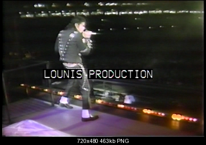

    I would like to fix the problem on the bright area in the image below. I just want to make it white.. but I really don't know how to do.
    When, I play with the Levels(), I notice that these pink areas remain stable.. I can darken or whiten the image completely, these areas (and only them) will always remain pink.

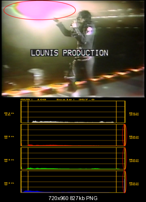

    Also, is there a way to fix these annoying 'waves' on the film..

  2. Something like this maybe:
    mask=ColorYUV(off_y=-200).ColorYUV(gain_y=20000)
    Overlay(last, ColorYUV(last,cont_u=-256, cont_v=-256), 0, 0, mask)
    You can fine tune it.
    Or maybe a mask built from the U channel (U is very high where the purple colors are), or both Y and U. Or try a chroma key.
    Chroma based mask:
     mask=UtoY().BilinearResize(width,height).ColorYUV(off_y=-120).ColorYUV(gain_y=10000)

    You could try brightening the grey image before Overlay(). Try adding gain_y=20 to the ColorYUV() statement.

  6. Do you have any suggestion about the 'wave' effect?

  7. I'd probably leave the purple splotches. It' part of the charm of the video. Neat Video might help with the wavy bars.

    To fix it, I'd try some techniques from re-colouring, like the colorit filters. They can be used to do a type of flood fill or to selectively replace all purple colours with white.
    As for the wavy lines, you need vcmohamn's fan filter plugin, it's made just for this. (fan refers to the interference caused by a fan motor on a VHS on the same electrical branch circuit)

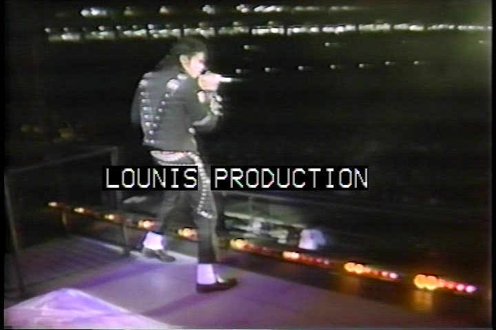

  9. Banned
    New York, US
    The pink flare is from a pink spotlight. You can see it's aimed at Michael and is directed onto the stage floor (pink circle in lower right). It's not supposed to be white.
    [Attachment 14786 - Click to enlarge]
