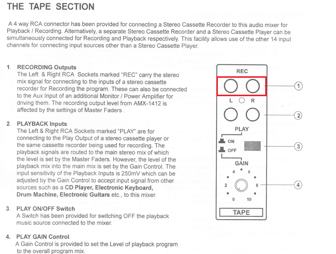

    Assuming:
    1. You are NOT going to be doing the actual mixing yourself, but are relying on another mixing person to be sending the stuff to you.
    2. The mixing person can give you "TONE" (aka a steady-state sine wave, usually @ ~1kHz) to set up/calibrate your recorder.
    Make sure you have a RCA stereo plug pair - to - 1/8" STEREO Phono plug (single) - will look like a Y cable.
    The RCA plugs will go into the L + R of the "TAPE" REC OUT jacks on the mixer.
    The 1/8" STEREO phono plug will go into the H1 external input jack.
    Make sure you set your H1 as follows:
    1. Input to EXTERNAL MICS
    2. Lo-cut filter OFF
    3. Automatic LEVEL OFF
    4. Input level: LINE LEVEL (NOT mike level)
    5. WAV settings as good as possible (24/96 or 24/48 or 24/44.1 or 16/44.1, in descending order)
    Then, with the mixing person giving you a TONE with all levels set to UNITY (aka 0 dB), you would set your H1 to Rec Ready and adjust the level to = ~ -18 or -20dB below Full Signal/Clipping, which will give you a good amount of headroom. Then, you would only clip if the mixer clipped, and your dynamic range is matched to what the mixer is capable of.

    I have attached an image from the manual of the mixer , i have marked the two ports in red , can i just plug in my rca cord to these ports and then plug the 3.5mm to the zoom h1 ???
    Link to the manual : http://www.ahujaradios.com/Literature/AMX-1412.pdf
    Looking forward to your reply...Thank you again.
