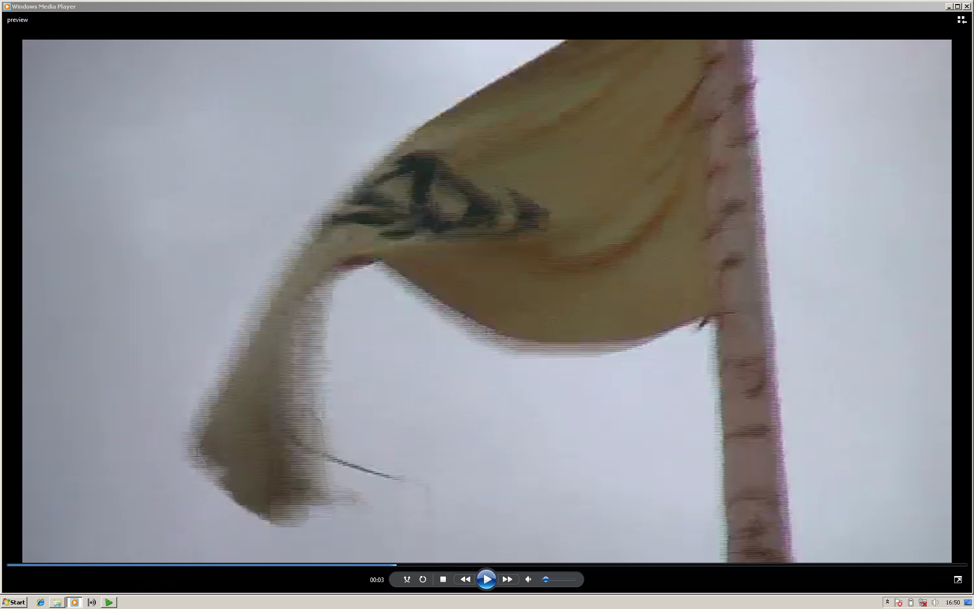

    I used HandBrake to convert the file to MP4 format, but i noticed that there were lines all over the place
    here's a photo to show you
    <<Attachment at bottom of page>>
    Should i use the Decomb filter (Default) of the Deinterlace filter (slower), as i'm reading that a lot of people use decomb, while others say if your video is Interlace use that, Or should i use both, ive tryed both of them and they work, but which one would you recommend

    Yes. Use the one that looks better....and if you can't see any difference use the faster one.

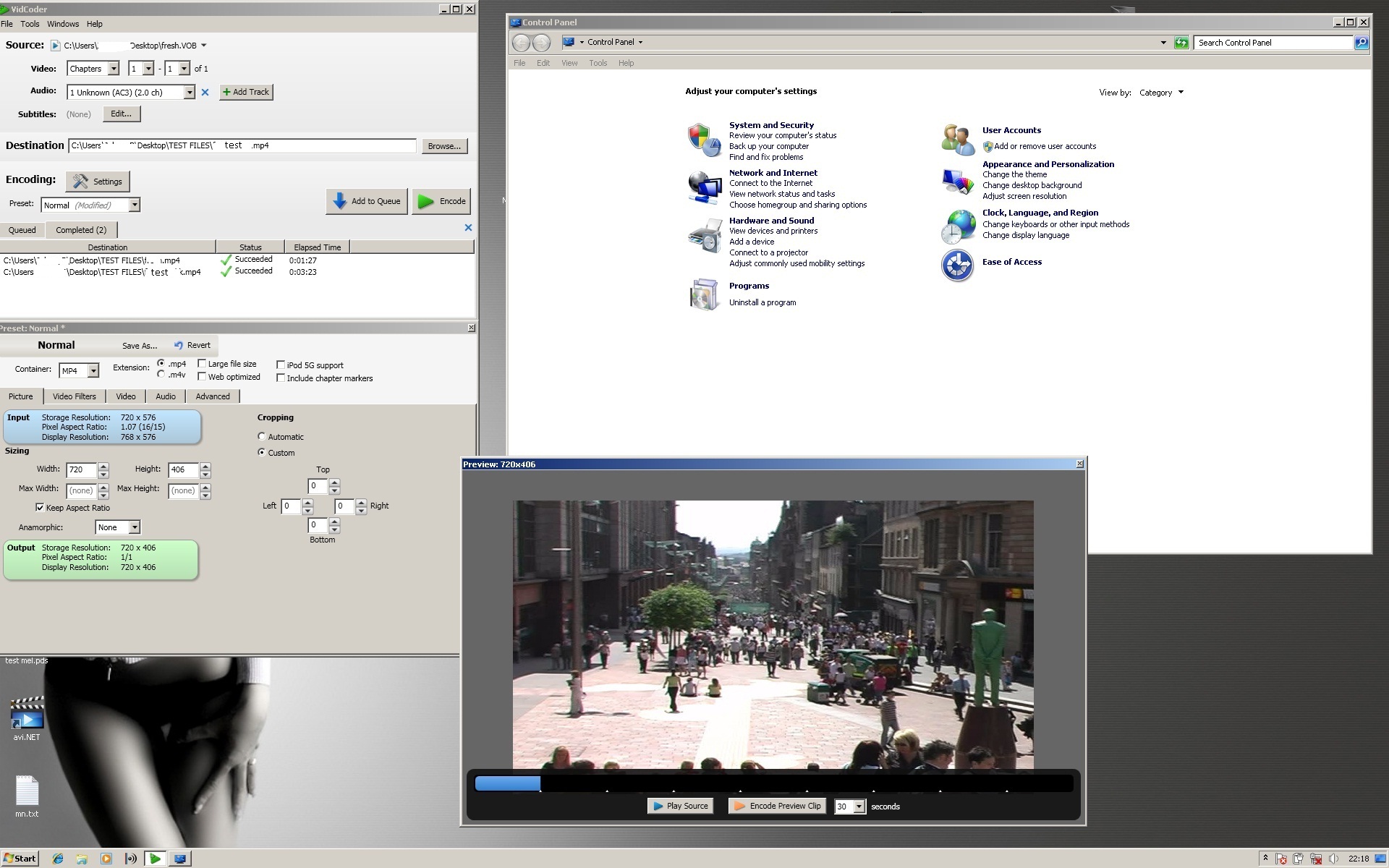

    Hello
    Thank you in responding, I did look at the orignal vob file and the 16:9 mp4 file carefully and i could'nt see any stretching anywhere on my 32" LCD (maybe its my eyes, but i had my nose pressed to the screen)
    I been reading all day about this and I dont know if the experts here recommend this for 'senior newbies' as a quick fix as you get a perfect fit, but then image size becomes 1024x576, which again i dont mind.
    So i went back to the orginal VOB file (4:3) took it into handbrake
    and did this
    Please see attached picture
    Set the sizeing to 720 x 406 keep aspect ratio is this the right setting for a PAL 720 x 576
    I then ran the clip through my bluray player and its ok, just a small black border on sides about half inch (how can i lose these maybe use 720 x 420)
    Can you tell me if thats the right setting....
    I can either use the first step 4:3 to 16:9
    or
    I would like to do it the 2nd way, and whats the advantage over it compared to the first way, and i'm i losing something
    Bob
  5. Originally Posted by bob52 View Post
    If you don't see any interlacing, then it's not interlaced and you shouldn't deinterlace. Most progressive PAL DVDs are encoded as interlaced. MediaInfo tells you only how it was encoded and nothing about the real content. In your first picture I don't see any interlacing (although maybe your player deinterlaced it). Don't really know. You could always upload us a small piece to examine, if you can't figure it out yourself.
    Also, your lower picture isn't a good example, but it looks to me like it really might be 4:3 and you shouldn't have changed it to 16:9. Can't you find anything round in the film to check? You can play it in a player that allows for the changing of the aspect ratio (Media Player Classic Home Cinema, for example) and switch back and forth between 16:9 and 4:3 to see which looks more 'normal'.

  7. I suspect your underlying video is progressive but the fields are stored out of phase -- ie, each frame contains fields from two separate film frames. These can be restored to fully progressive frames with a field delay filter. I recommend you post a short sample demuxed from your VOB files (not re-encoded). You can use DgIndex or Mpg2Cut2.
