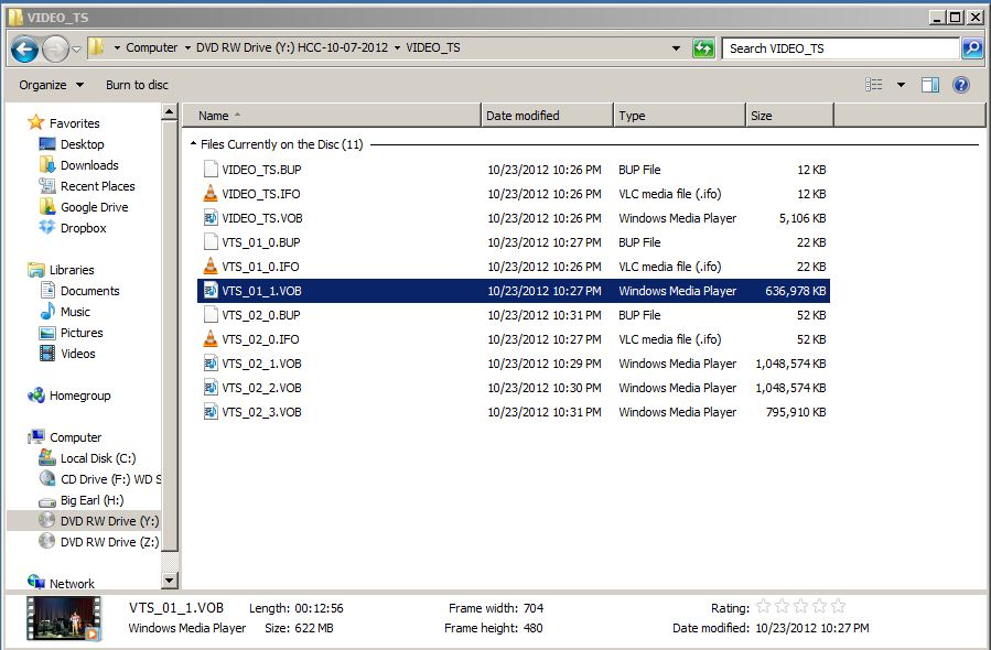

    So here are my screen grabs. The first is from the old (dead) burner we used to use. This disk still rips fine. Please note the length that shows at the bottom of the screen. It directly matches what will rip off of the disk.
    Old Unit

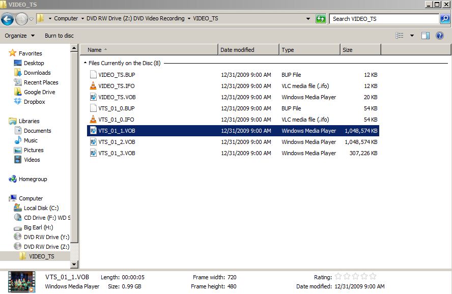

    Next is the New Toshiba. It actually shows fewer files in this window that the old one did. Once again note the length that appears. This directly corresponds with what will rip. However, instead of 5 seconds the video length is 30 minutes.

    @traylor1, in your first post, you mentioned file size as .99 MB but here the Screenshot shows as .99 GB means almost 1 GB
  4. Member DB83's Avatar
    Jul 2007
    I will echo what is said above. The file size is reported correctly at .99 gig. It's playback time is being incorrectly reported. That is an OS issue or WMP is corrupt.
    I would not worry about the fewer files on the second disk. The first had two titles. The second only one
    But are you absolutely sure that you have not also misread the ripped file. If that shows the same then there is no issue. Try a raw playback of the ripped vob.
