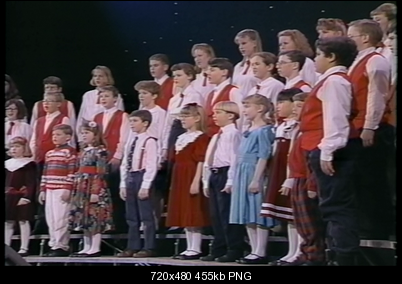

    So if brassplyer's original goal (and purpose of this thread) was to optimize clarity and resolution - that's going to be a trade off vs noise reduction . That's a subjective choice. Personally I'm not a fan of the "oil painting plastiky look" , which is the result of overzealous denoising and sharpening. VHS doesn't contain a whole lot of detail to begin with but I would rather attempt preserve whatever fine details in the crappy VHS at the expense of a bit of noise .
    Yep. My 2 trials went to the edge trying to clean up that grimy blue background. But ran out of time here. With more runs, it would likely be better to spend less time on the kids and put more into the worst of the noise in the blue backdrop.
    I agree with Sanlyn that there is a red color cast, but there is a lot of subjectivity in regards to color and grading . Everyone is going to have a different opinion on what the colors should look like - but I think we can all agree the shirts are supposed to be "white". The thing is , in real life , lights are never 100% white, so shirts are never 100% white. There is always a color temperature to lighting, whether artifical or natural. I think it would be a mistake to match the shirts to perfect equal R=G=B white values. Not only does it look unnatural - this probably means you will reduce the fine detail in the shirts as you clip the high end or stretch the curve too much using an 8 bit format
    Good points. I'm sometimes prodded into the oversharpen/oversaturate bit getting so popular now, but....it never looks right to me. It might be temporarily eye popping, but it's unreal and you tiring. The only time white shirts look like RGB=240 or brighter is in home flash digital shots with the flash a few scant feet away. White shirts seldom look that white in movies. And there is often a hint of yellow or some graying-down to avoid looking artificially lighted. "Perfect" white looks rather odd in video, like "perfect" reds, etc. One thing I didn't like about my 2 tries was that the shirts are too bright, which burned more of the few highlights that were left. Will add these two clips to my give-it-a-few-more-tries folder. General rule: when you think it's finally looking better, wait 3 days.

  6. Banned
    New York, US
    I'm seeing "cool" colors.
    Not really (although, like my attempts, gamma might be a bit high). The color that's in short supply isn't red, and wouldn't want to cut blue. The deficit color is green. Get your pixel reader and you'll see what I mean. Problem: with the screwy colors in the original, adding green makes the reds more mellow but the kids look sickly. It would take a lot of time and tricky effort to clean up that video. Wonder what happened to it, or if it was just mastered that way.

    New York, US
    I started to turn in for the night, but your comment wouldn't leave me alone. "Cool" is an optical illusion. The top photo posted below is the one you posted. It's still too red -- actually, it's magenta (red+blue). The bottom photo is the same image' the only change was to add green above RGB 80. Click on an image to load it into the forum image viewer, then swith back and forth between the two. Green mellows red a bit, but also brightens the shirts. Problem: now the kids faces are starting to look to green, and overall impression is that the shirts are too "bright". So...more work, for another day.
    [Attachment 14446 - Click to enlarge]
    [Attachment 14447 - Click to enlarge]
    To make the difference seem moe clear, I added about 2 or 3 points too much bright green. Sometimes a little goes a long way.

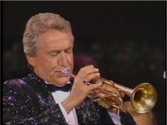

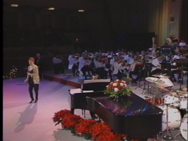

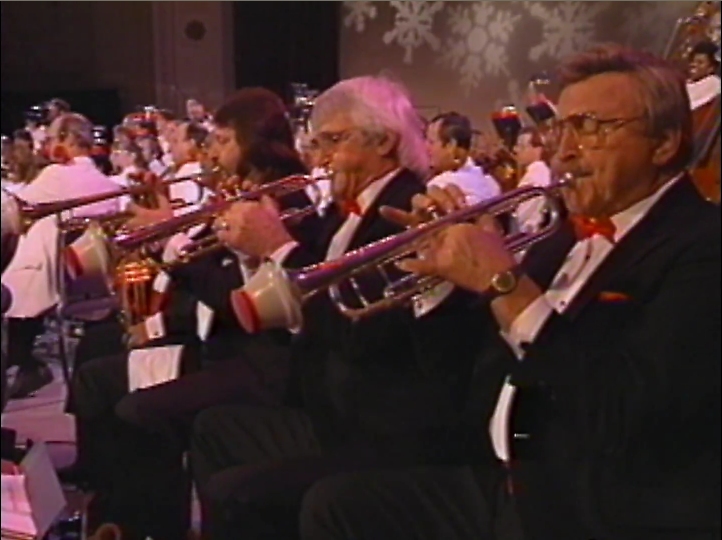

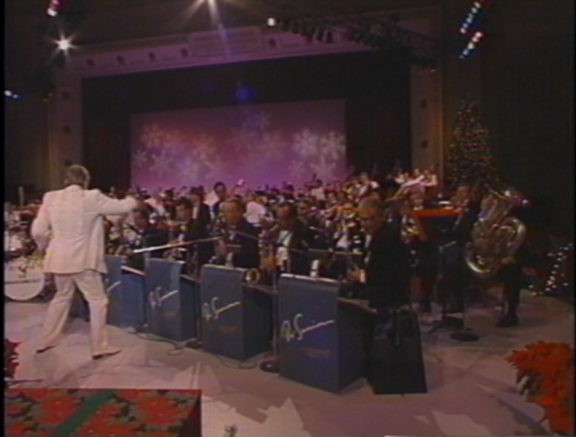

  15. Member brassplyer's Avatar
    Apr 2008
    Video1_white_gray:
    (1) whites aren't white. (2) Shadows on white aren't gray; they're purple. But some of it ooks like lighting effects and reflections from other clothing. Not an easy fix.
    [Attachment 14432 - Click to enlarge]
    I think it's pretty much exclusively due to the lighting. I.e. I believe they're supposed to look that way. Notice how various elements pick up the blue tint - the back of Conte Candoli's hair (the center trumpet in the one shot), parts of the jackets seemingly depending on how the blue light hits them - parts of the jackets are quite white. Part of the area of the stage floor, part of the stage where the kids' choir is seen in my example. Note the one shot of Doc in front of the band, his suit is plenty white while the stage backdrop and part of the frame around it is very purple, but part isn't. Also gets picked up in the reflections off the brass instruments.

  17. Member brassplyer's Avatar
    Apr 2008
    Ive seen this before. Due to a magnetic field.
    In this case I think it's due to spotlights.
  18. Originally Posted by brassplyer View Post
    Of course. It's stage lighting. Colored lights on the background, white spotlight on the featured performer.
    Very good corrections, sanlyn.
    There's actually several things that can still be done about the chroma noise.
    And I find a lot of people who disagree about colors tend to not be using accurate monitors.
    Unless they give their specs (like your calibrated IPS), I tend to assume low-end cheap monitors.
    And therefore their opinion doesn't matter a whole lot.

  22. My point wasn't that the color was perfect in every shot but that often there should be a blue or purple cast in parts of the picture because blue and purple lights where used as mood lighting.

  25. Yes, the white haired trumpeter's hair should be purple because there is a purple light shining on him That's also consistent with the floor, the sheet music, and the guy in the white coat at the left edge.

  28. Video Restorer lordsmurf's Avatar
    I believe that this is the correct WB.
    It's way, way, way off. I think your monitor is way out of spec. It has a very yellow/brown shift, and all of the whites are tinted pink.
    Then whoever shot the video must have left the WB on "auto", or inappropriate setting.
    Actually, you have that backwards. WB changing would have compensated for the colored lights. (Or rather, tried to, and made a bigger mess.)
