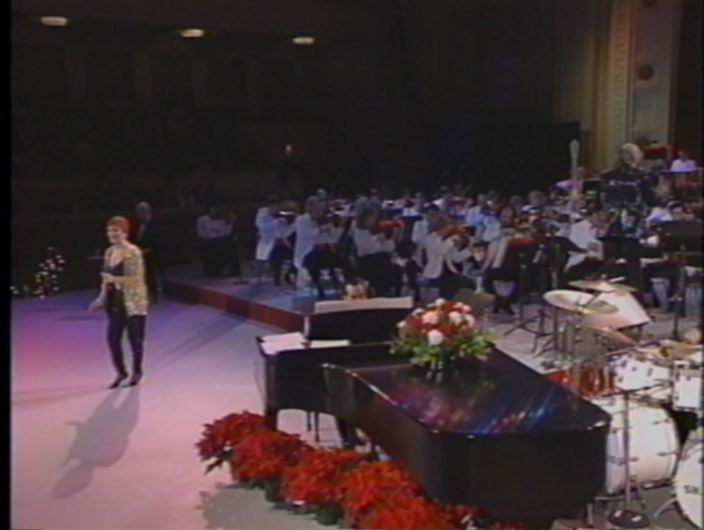

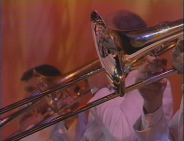

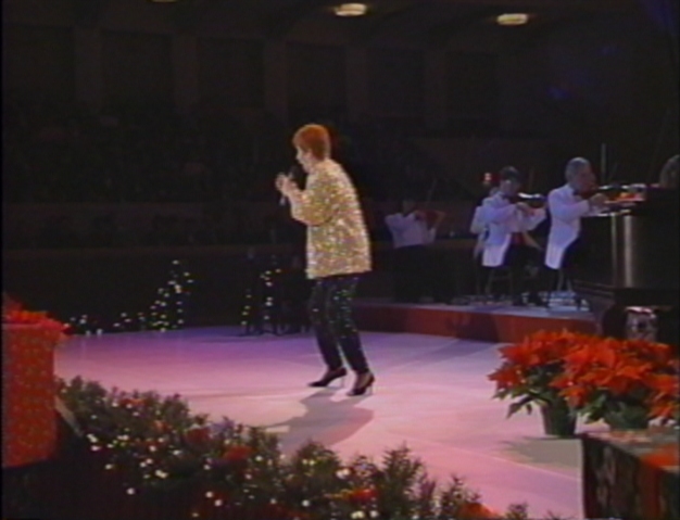

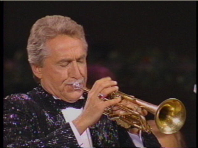

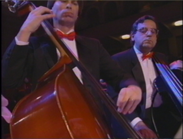

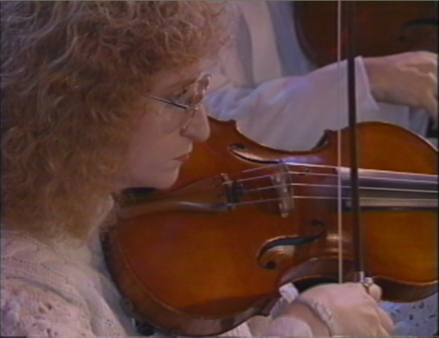

    I'm including some screen caps off Vdub from the original - the only processing that's been done is a deinterlacing filter. No adjustment on the color or contrast. The reds don't look all that bad to me. The poinsettias look about right - there's very definite distinction between the tone of the roses and the poinsettias - and where they're more brightly lit in some spots than others. Same with the kids' clothes - I see a lot of subtle differences in the red tones. I'd say the wood tones of the viola and bass look pretty spot on. There are also some shots of cup mutes that look like mine.
Name:	Poinsettias and roses.jpg
Name:	Poinsettias and roses 2.jpg
Name:	Doc and horn.jpg

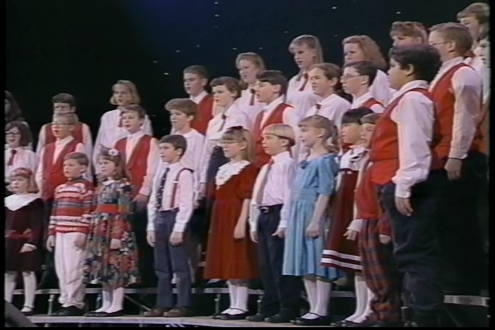

    If I interpret what you're saying correctly, you're insisting I have inferior sensibilities. ~shrug~

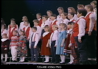

    Are you of the opinion that the screen shot of the kids you put up looks natural, that the color is an accurate representation?

    New York, US
    I wouldn't say that's a fair interpretation. People make their videos look the way they want. If you were to say a clip looks too blue or too green, and ask for ways to correct it, you'd get several suggestions. The clip with the kids has oversaturated reds. I look at it and say whites aren't white, grays aren't gray, blacks aren't clean, detail was crushed and highlights were clipped during capture. The blue background has coarse grain and noisy gradations. Not an easy clip to fix. Tape aging affects colors in odd ways (in this case, green is fading faster than the other colors). Many tapes defy "accurate" color and levels correction. Video2 has bleed and chroma shift -- most people don't worry about it, they just sharpen. V2 has coarse shadow noise, something I've seen in many captures here. I've tried for some time to figure out which VCR's are doing this (it doesn't appear in my captures, so I have no idea where this coarseness comes from). There are edge and motion problems, low-level motion noise (you can expect that with VHS). There are annoying interlace effects in both clips that I don't know how to fix. I keep looking for answers to that, too, other than to just de-interlace.
    Video2 demonstrates a typical VHS difficulty with color correction: there are three different camera shots, each with differences in color balance. Mixed lighting in the scene (colored lights) is one problem. I tried correcting for flesh tones, which is touchy because the singer's skin tones vary among all three shots. I started to address your earlier comment that one wouldn't know how a scene is supposed to look because one "wasn't there" when the scene was shot. That's true. What colorists would do is to first set correct levels and check for crushed darks and blown-out highlights. Then they would set the white point, the black point, and the gray point. You do this by eye and with histograms and pixel samplers. Sometimes there are no proper objects to sample (a singer lighted by colored floods and spots, for example), so you just guess.
    Someone mentioned using a line tbc of some sort. I don't see much in terms of line timing effects (edges are straight and don't wiggle), so I'm thinking your camera's pass-thru has a tbc. That's an advantage -- those problems can't be repaired after capture, so you're one step ahead with that camera. Sony's 4:1:1 recorded colorspace was a problem for me (many Avisynth filters don't work with 4:1:1, and converting to RGB looked a little strange at times. Anyone have a take on this ? ? ?).
    Some people would agree with a correction, others wouldn't. I see both clips as good exercises in learning to fix color problems. I'd probably spend more time and do some research on why some techniques don't respond the way I wanted. But that's just me. If you like the results, you're getting what you want.
    This is what I see in the original Video1:
    video1 RGB histogram: (1) crushed darks, suppressed midtones, lack of brilliance. (2) oversaturated red relative to other colors, and red "blooming". (3) suppressed bright green.
    [Attachment 14429 - Click to enlarge]
    vido1_noise_lowdensity: noise and rough gradations in background. Flat skin tones, lack of definition due to low density in lower part of histogr5am. Sharpening won't help; midtones need to be expanded.
    [Attachment 14430 - Click to enlarge]
    video1_colors_density: low contrast and suppressed midtones give two-dimensional murky appearance. No detail in highlights; sharpening makes it worse. Dark-haired kids on the right have purple hair (dark blues too bright). Shirts aren't white; they are magenta (bright green suppressed).
    [Attachment 14431 - Click to enlarge]
    Video1_white_gray:
    (1) whites aren't white. (2) Shadows on white aren't gray; they're purple.
    [Attachment 14432 - Click to enlarge]
    Not everyone wants the same thing. The tools are there for whatever we want. I gave it a try, but I'm not real happy with it. Histogram is still a mess, and noisy blue background. But it's a start. I did manage to fix the horizontal rip in frames 127 and 128.
    [Attachment 14433 - Click to enlarge]

    Obviously, the reds would be very vibrant in what appears to be holiday apparel. The standard is Santa Claus red.
  18. Banned
    New York, US
    Two versions were posted, one more blue, one more red.
    The monitors are IPS LCD's from LG and HP, 38-point calibrated with EyeOne Display 2/Xrite. Not using the CRT right now. The HD LCD and plasma are calibrated the same way, to ISF/D6500 standard . How is yours set up?
    Vibrant and blooming are two different things. I didn't know that Santa Claus Red was a standard color. I didn't know CRT's were supposed to be more red than LCD's. It's usually LCD's that are set up with pushed reds adn odd color temps like 9000K.
