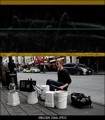

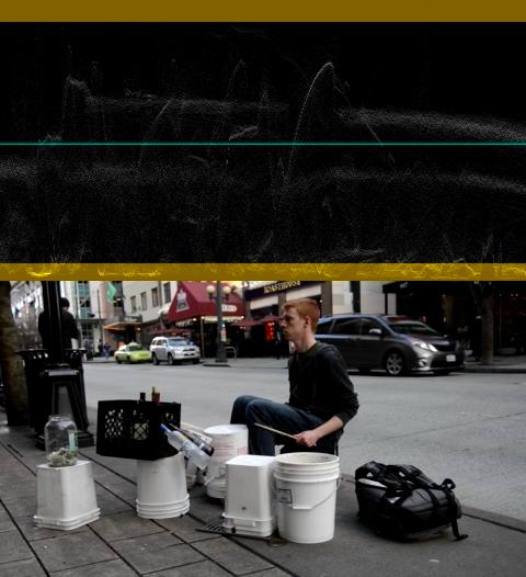

  7. You're right. I downloaded a few of the videos in that review and they use the PC.601 matrix (frame size reduced):
    You can see excursions below Y=16 (it's hard to see in these small images with little bright content but there are excursions above Y=235 too) and that blacks are crushed by incorrect conversion to RGB using the rec.601 matrix.
    Below is the image after correcting for PC to TV levels (ColorYUV(levels="PC->TV") in AviSynth):
    MediaInfo shows the use of the BT.601 matrix (usually used for standard definition), not BT.709 (usually used for high definition):

    Andrewgerm, if you upload a short sample I'll take a look at it. Use a clip with a mix of bright and dark content. Something with a known color would be good too -- especially reds (where the difference between the 601 and 709 matrices is most obvious).
