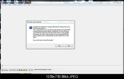

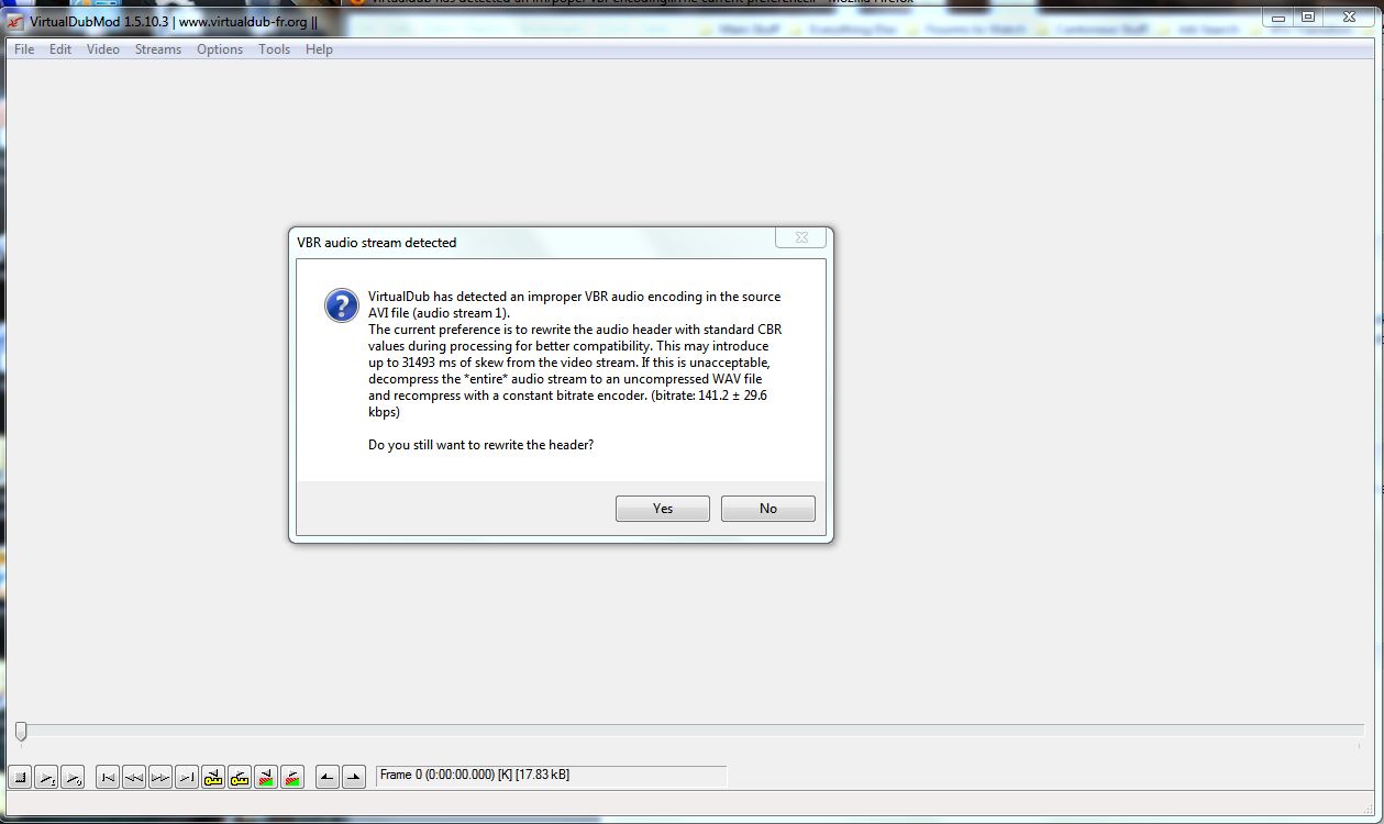

    I am currently using VirtualDubMod 1.5.10.3 since I that historically works. Since our objective is just a simple re-encode of an AVI file, I opened the original file in question directly in VDM, as suggested. This is what happens:
    So I get a warning about VBR audio streams and re-writing headers. I have done a bit of research on this, and have read that if I click "No" and then fully re-encode the audio with "Full Processing Mode" and something like LAME MP3, the resulting video should not have any audio sync problems. Is this true?
    Of course, I would also be re-encoding the video portion to get rid of the GMC problems too.
    Thanks for the help so far!

  7. Originally Posted by adalect View Post
    If there's nothing wrong with the current audio, why reencode it? Click 'No' to the question and keep it on 'Direct Stream Copy'.
  8. Originally Posted by adalect View Post
    Yes. I seem to recall that sometimes you have to select Yes instead of No.
    Some old players don't like VBR MP3.
    I had thought of that but since he didn't mention anything about reencoding it as CBR, I didn't think that was what he was thinking of doing - that just the act of reencoding it would somehow keep it in synch.
