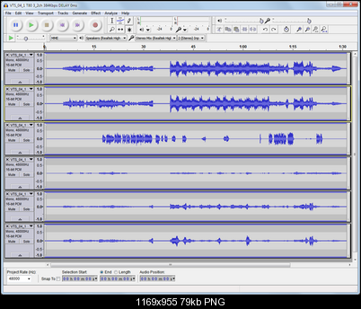

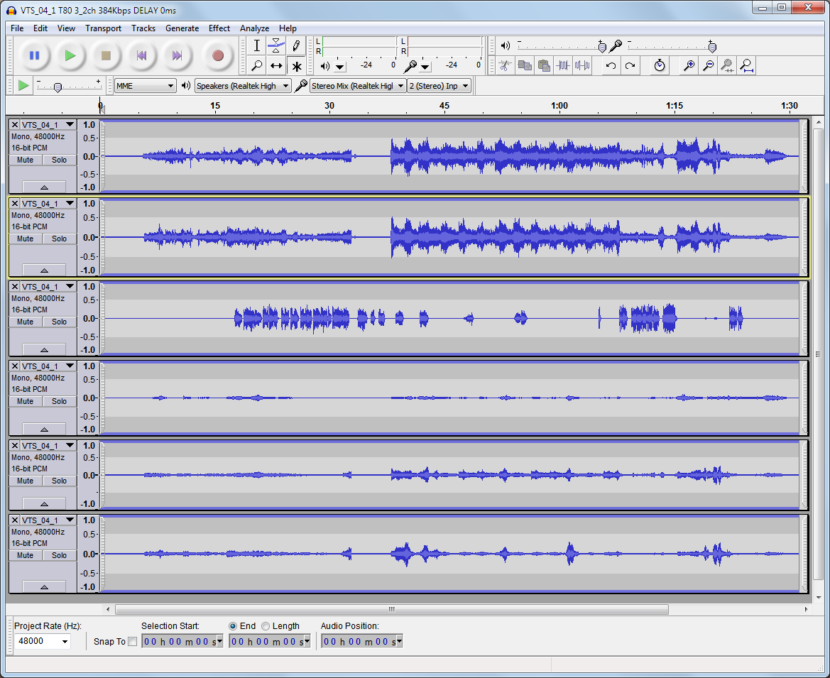

  21. Install Audacity and the ffmpeg source plugin.
    http://manual.audacityteam.org/o/man/faq_installation_and_plug_ins.html#ffdown
    Import one of your AC3 files and see exactly what you have. You can play each channel separately with Audacity (use the "solo" button). A 5.1 AC3 track:

  22. Also, using BeSweet and a GUI (and maybe other programs too?) you can convert the DD 5.1 AC3 to 6 different Mono WAV files. You can play each one to see which ones (if any) give you music only.

    Woo-Hoo!! I got it to work and I now have one of the songs as an mpeg with no guide vocals!!! Here is the process that worked from beginning to end in case anyone else has to do what I am doing. First use either PGCDemux or DVD Decrypter and demux the songs VOB file. Next, take the one audio ac3 file that the vocals can be removed from (mine were titled AudioFile_80.ac3) and delete the audio ac3 file that the vocals can't be removed from (mine were titled AudiioFile_81.ac3). Next import the audio file into Audacity with the ffmpeg plugin. I ended up with 5 channels, the first 3 were different parts of the music and the backgound vocals (which I wanted to keep and probably would have lost if I ended up using a vocal remover), and the 4th one was the male vocals and the 5th the female vocals. I selected solo as recommended so I could figure out which ones I wanted to keep and which ones I wanted to delete. I then selected each of the 4th and 5th ones and used the split delete command to get rid of them. I saved the remaining 3 and used the file export command to save twice to end up with two ac3 audio files to simulate stereo and used the file names the same as the ones that were demuxed from the vob file (AudioFile_80 and _81.ac3). Last I used ImagoMPEG-Muxer and selected the demuxed video file and the 2 audio ac3 files I just created in Audacity and successfully have an MPEG with music and background vocals only!! You guys were great help and I really appreciate it. I hope someone else can benefit from all of this so they won't have 2 spend 3 days figuring out like I did. Many THANKS again! Now off to do this all with the remaining 11 songs
