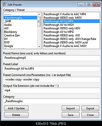

  9. It's very easy to create (or modify) presets in winff using regular ffmpeg commands. Here's a screenshot of one I created that does what you want.

  12. yeah also, i dont have that _Passthrough preset at all. did you create all of those passthrough options?

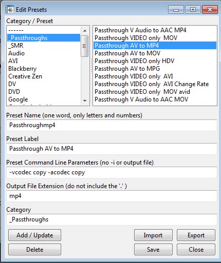

  13. i just copied what you had showed. is there any way to integrate avisynth into this process so that I can hardcode my ass subtitles? i know its a little off the topic of this forum but that was my original goal (convert to mp4 with hardcoded subtitles so that I can play them on appletv)
    Yes, _Passthrough was created simply by entering it in the category box. It is not part of the preset package that comes with winff. The name starts with an underscore so it will show up near the top of the category dropdown.
