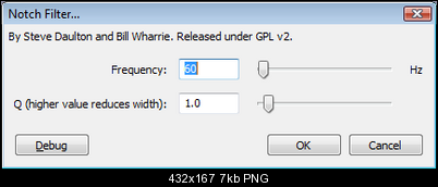

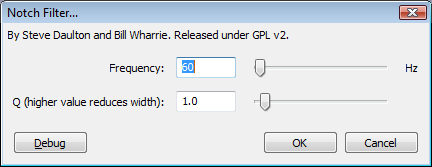

  25. Originally Posted by jagabo View Post
    I used the notch filter in Audacity to remove the buzz. I use a Q factor of 10 and applied it at 60, 120, 180, 240, 300, 360, and 420 Hz. Maybe at 480, 540, and 600 too, I don't remember for sure. Do you still hear your "rumble" in this file?
    In Audacity 2.0.0 I go to Effect, Notch Filter. I see this window:
Name:	Audacity Notch Filter.png
    I don't see any place to enter multiple numbers?
  26. Originally Posted by holygamer View Post
    You run the filter multiple times, once (or more) at each of the indicated frequencies.
