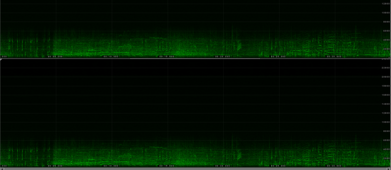

    it's not "rumble". i don't see or hear any repetitive low freq noise. the best i could do was to band pass/noise gate it between 300 and 10khtz.
  3. Thanks but I don't notice any difference. The rumble or whatever it is, is still there after I remove the hiss.
