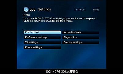

    I'm trying to archive recordings from a upc cable recorder. I've connected a dvd recorder by scart and this records from the upc box and plays back the programmes on my widescreen tv no problem.
    The problem happens when I take the recorded dvd from the dvd recorder and try to rip it (using Imgburn) and/or compress it (using Handbrake) on a pc. The resultant (whether compressed or uncompressed) files all have black bars to the left and right of the picture. Even if I play the dvd directly on the pc I get the side bars.
    I've spend weeks Googling this and also tried altering every setting I can see on the upc box both to no avail. If anyone can point me in the right direction I'd be very grateful! Thanks.

    That clip has a 4:3 aspect ratio. It's neither a wide screen image nor a wide screen aspect ratio. It should play on any wide screen monitor with side pillars. If you're playing this mernu clip on a wide screen TV and it fills the screen, the image has been stretched on your TV, which means you're playing it incorrectly.
    No idea what's on the other parts of the DVD video. You submitted a menu screen.

    I'm sure the DVD is 4:3 and it's supposed to play on your widescreen TV set with big pillarbars (side bars). So, you're capping 4:3 material from standard definition channels, and not hi-def channels, right? Or maybe the DVD recorder only records in 4:3? But for future reference, upload a piece of the actual movie. Open a VOB in DGIndex. Scroll to a place with video from the movie. Use the [ and ] buttons to isolate a small 10 second piece. Then File->Save Project and Demux Video. Upload the resulting M2V file.
  9. Yes, the menu may not be indicative of movie content. As others have said, the VOB is 4:3 DAR and should show with pillarboxes on a 16:9 TV:

    And the video itself has small black borders (8 to 10 pixels) at the left and right edges, as most analog video captures do.

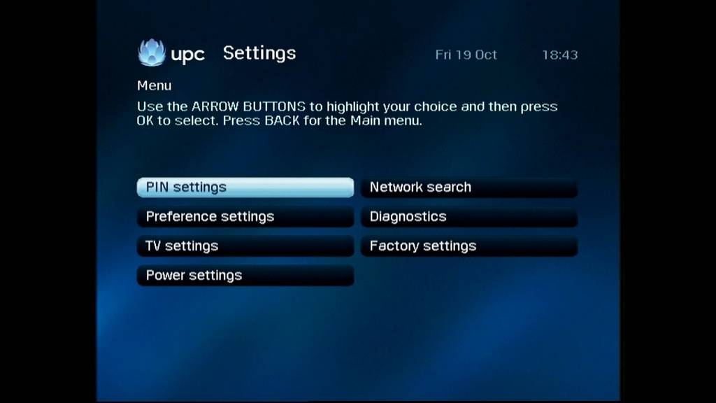

    That first file was a dvd recording of the menu from the upc cable box (not a DVD menu). I chose for the "o" letters to allow you judge the aspect ratio. They look right on my widescreen telly (I think anyway).
    This second upload is a short section of dvd recording from BBC News.
    Thanks very much for your help guys. This has me completely fooled.

    mkv ain't dvd. The mkv plays on my 'puter as 4:5 (squished), no side bars. I thought your original post stated you had DVD's (not mkv's) that played pillared. If this came from your DVD recorder, it's been re-processed. Can't help you there.

  12. Yeah, but it does look as if it's supposed to be 16:9, no matter how it was capped and no matter how it was further ruined by the reencode.
    Just a guess here (and as sanlyn mentioned, no real way to tell without an untouched sample), but I think the recorder only caps 4:3 (maybe check the manual?) and you'll have to resize it in the reencode, to something like 640x360, or set a PAR in the resulting MKV.

    I figured it was recorded 4:3 and flagged for 16:9, but whatever made the mkv kept the original 4"5 PAL AR. But couldn't say for sure without a piece of the vob .
