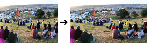

    DVD-Video has the aspect ratio in two places: inside the MPEG-2 stream and inside the IFO file. If these do not match, then the DVD player should use the IFO setting.
    This behavior gives you an opportunity to fix a bad aspect ratio by simply altering the setting in the IFO file for that Video Title Set (VTS).
    So you can author a DVD as you normally would, keeping the faulty feature in a separate VTS, and then generate a VIDEO_TS folder.
    Then load the VIDEO_TS folder in e.g. MyDVDEdit and change the aspect ratio for the faulty VTS. This will change an aspect ratio setting in the IFO file for that VTS.
    This would stretch the 4:3 video to 16:9, like in the image below:
