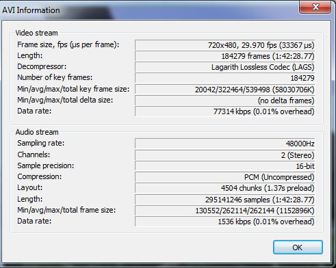

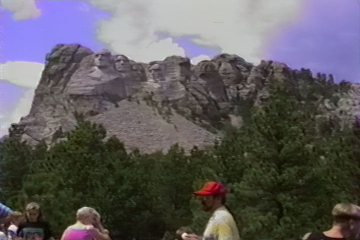

    Here is some video info:

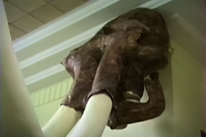

  6. Member LSchafroth's Avatar
    Dec 2002
    2nd sample

  8. Pictures are useless (particularly after it's already been deinterlaced). Is it a movie? If so deinterlacing is the wrong thing to do. If you don't know, an untouched short video sample can help. 2-3 seconds of steady movement will be plenty.

  10. WTF is the 2nd picture of ? some alien-predator-elephant hybrid ?
  11. I see then you do it wrong because camcorder footage is truly interlaced so when you deinterlace you lose vital information basically not to mention yadif ain't exactly a top notch deinterlacer in my eyes, you lose information and you introduce artefacts so it's a double no-no (and the double no-no of the week is..) * joke
    Lol. Its a vacation video from the black hills. Mt Rushmore. I assume it is a mammoth.
