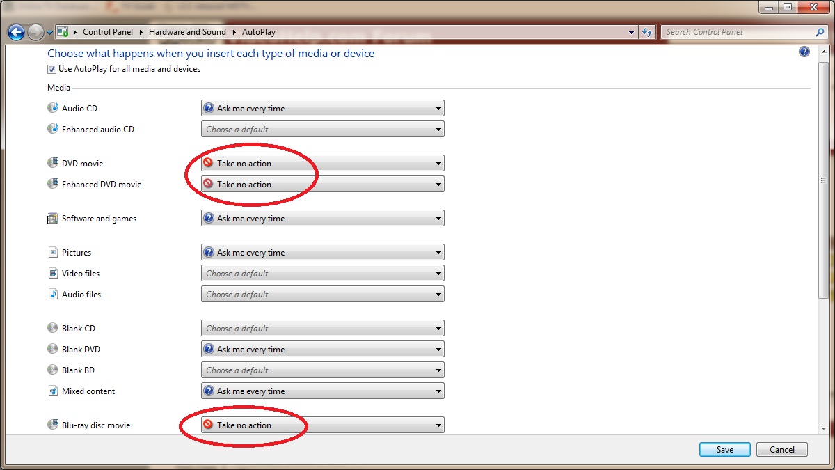

    You could try disabling the autoplay feature so that when you insert a disc the computer doesn't try to auto load any software. Win7 has this feature, not sure about xp though, it would be somewhere in Control Panel if it does.
  16. Originally Posted by ronmaz View Post
    XP has the option. It doesn't have multiple settings for disc content. Just one enable/disable. Search for XP Auto Insert Notification.
    Holding down the shift key does the same thing on a temporary basis.
