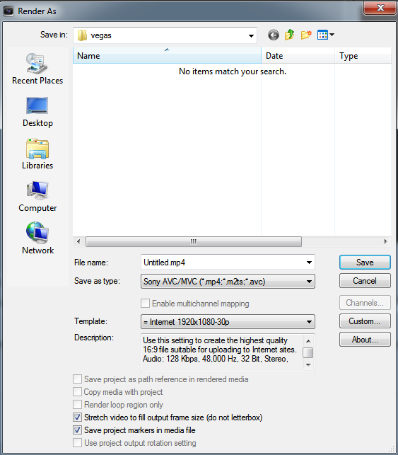

  1. What would be good render settings for a iPhone 5 to upload to YouTube?
    (Using sony vegas 10)
    I've tried some settings (1080p) but whenever I upload it to youtube, it comes out looking very grainy and blurry.

    youtube works best with h264/aac. i believe vegas pro 10 gave the best results with the sony avc encoder.

  3. I'll be sure to try this out.
    But one question, the raw file says that it's 24 FPS, do I still set the render settings as 30 FPS?
  4. Originally Posted by iRich View Post
    No, use the same fps as the original file
    Youtube is the weak link here - even if you upload a good quality video, it will lose a lot of quality once youtube re-encodes it

    if you are going to upload 1080p video to youtube make sure to use a high enough bitrate, i.e. over 10mbps.
