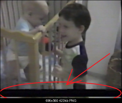

    source 1.avi:
    Problem - marked in the picture

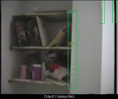

    source 2.avi:
    Problem - can not show with a picture .. You must download to understand ..
    This is movement problem ..
    I can not use RemapFrames in this case ..
    First need to fix the the movement problem ..

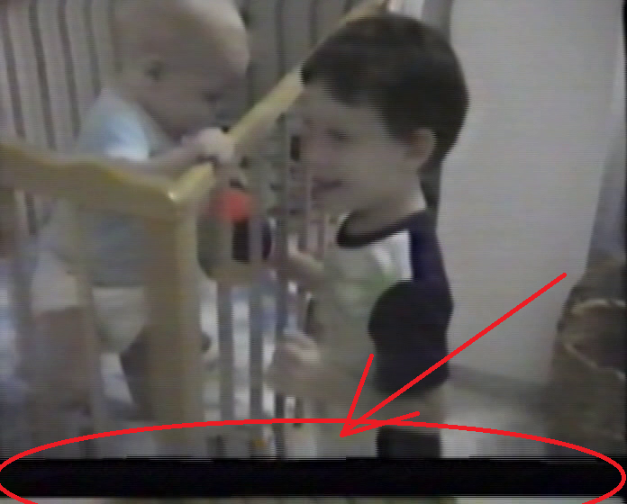

    I know the quality is bad ..
    Is this:
    tell you something?

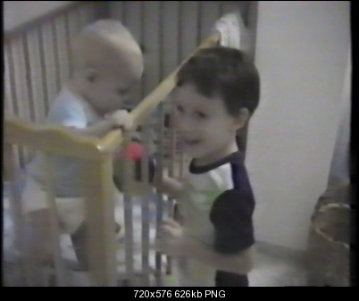

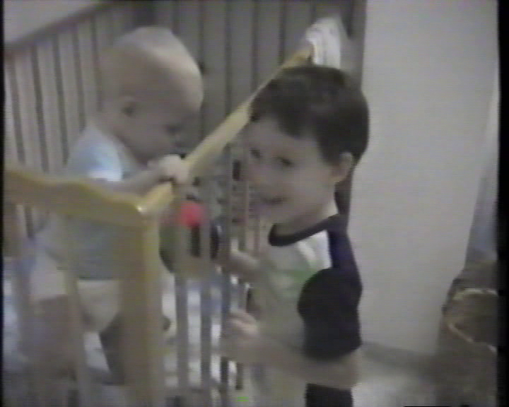

    ColorYUV(off_y=-5,cont_y=20,gain_y=15,gamma_y=-5)
    ColorYUV(cont_v=15,gain_v=3)
    Tweak(coring=false,Sat=1.5)
    Personally, I think it still looks somewhat "thin" and two-dimensional. But if you make the dark colors darker, the boy's shirt and dark hair will lose too much detail.

    Yes. The image tells me it's from tape, a soft and blurry image with very low contrast and low saturation. It has very little acutance or detail, so that strong sharpening would have little effect and would make it appear very strange. However, the colors seem accurate.

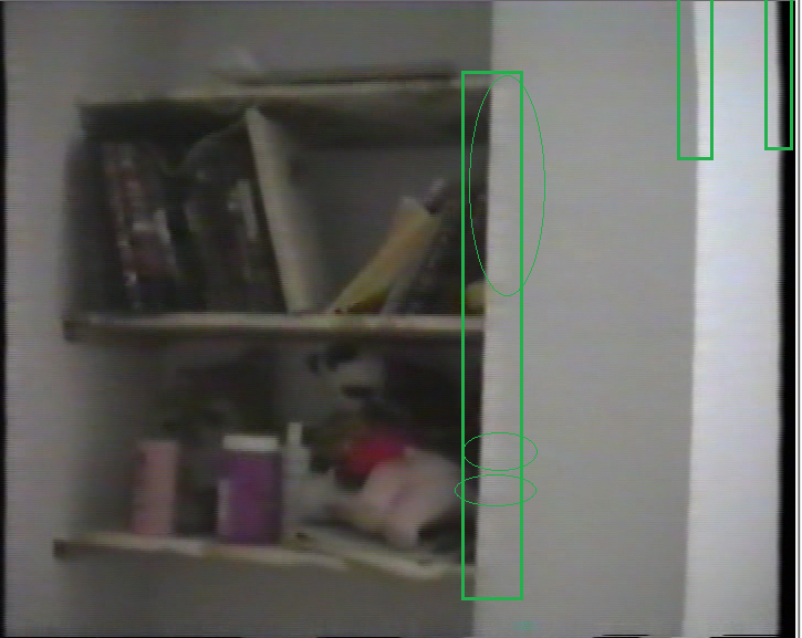

    By the way, I did type extra notes on the image you asked about in your earlier post. But somehow I deleted the remarks (dragged the mouse too quickly and typed over my own remarks). The edge smearing and trails along high-contrast edges is common with old tape and poor tracking, and MPEG encoders can cause these disturbances to look worse. If you had a few extra million euros you could buy software that can be configured to clean edge smearing and ghost trails. But it would take months to learn to use the product. With that much cash, you could buy better playback -- and it would still require some learning! I wish I could buy some for myself. Ah, well . . .
    Those streaks exist throughout the image (look at the left-hand border). During playback the streaking appears blurred because it moves quickly; in motion it has an appearance that some people call "horizontal rain". Because it is usually temporal (it varies from frame to frame) it can be partially cleaned with noise filters. When the noise is encoded, it is exaggerated and becomes more difficult to handle. I don't believe there is any way to remove it entirely.

    Those streaks exist throughout the image (look at the left-hand border, and in edges of shadows). During playback the streaks appear blurred because they move quickly; the fast streaking is sometimes described as "horizontal rain". Because it is usually temporal (it varies from frame to frame) it can be partially cleaned with noise filters. When the noise is encoded, it is exaggerated and becomes more difficult to handle. I don't believe it can be removed entirely.
