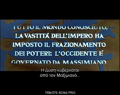

    I have a question concerning the "screen and bitmap size" options in MaestroSBT.
    I recently put subtitles in a PAL (720x576) DVD and I saw the default option for that was Minus 3.
    (I used Arrial Narrow 22, non bold, with outline 2 and was making sst subtitles)
    i was very happy with the result:

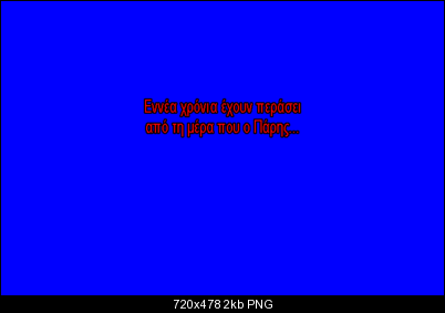

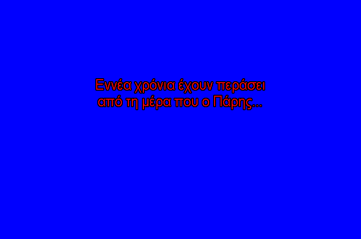

    Today, I tried to put subtitles in a NTSC (720x480) DVD and I saw the default option was Minus 2.
    i wasn't happy with the result (i used same style fonts):
    (don't pay attention to the colors and position, just the fonts)
    I tried with the same subtitles the Minus 3 option, like in the PAL dvd, and again I was happy with what I got. it was the same style with the first screenshot:

  2. Originally Posted by thinredline View Post
    Now, my question is:
    will it do any harm if I use Minus 3 for NTSC too, instead of the default Minus 2?
    I wouldn't, if I were you. I make all mine for NTSC with -2 and don't have any problems.
    I don't think the problem is the -2 or -3, but whether you're making them for 16:9 display or 4:3 display. Ideally, if your video is 16:9, you make 2 sets of subs in MaestroSBT, one for viewing on 4:3 TV sets, the other for 16:9 TV sets. It looks to me like the middle picture is for 16:9 display and the bottom one for 4:3.
    You can fool around with those settings in the Rendering page and then view them in the Preview. You'll easily see the differences. And neither shows them as they'll actually appear on your TV set, but only as they're stored in the DVD. To be sure of what you're getting, you'll have to actually view a finished DVD.
    And if the subs are too small for your tastes, you can always enlarge them. I usually make my 16:9 subs a little bit smaller than my 4:3 subs.

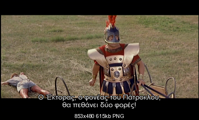

    here's the final result:

  5. Originally Posted by thinredline View Post
    The other ones were too narrow..
    Yes, because they're shown at the 720x576 resolution. When stretched out for display on your 16:9 TV set, they should become a lot more round.

    well, it didn't happen that way.
    I had already muxed the subtitles in the DVD and watched in my 16x9 screen and it was like this (narrow).
    then i deleted the DVD and I did it all over again..
