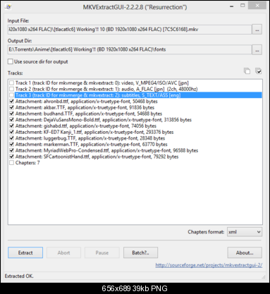

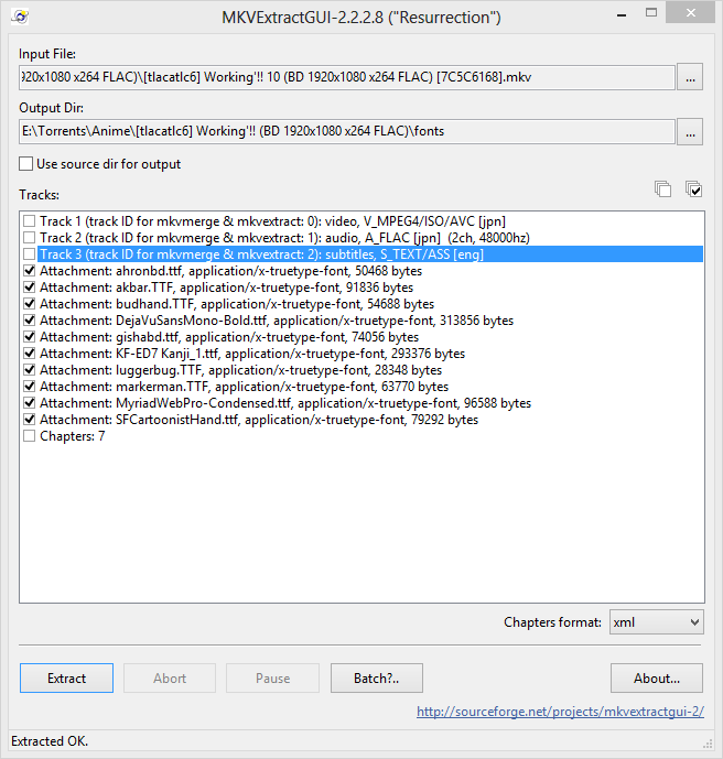

  1. I've got some MKV's that use custom fonts along with ASS subtitles. i've tried extracting them using MKVToolNix and MKVExtractGUI2 but it doesnt work. it tells me that it does but it doesnt actually.
    I've attached a screenshot (fonts.png) of MKVExtractGUI2 that shows me all of the fonts but if it is extracting them as it says it is, i cant find them anywhere.

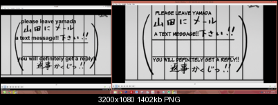

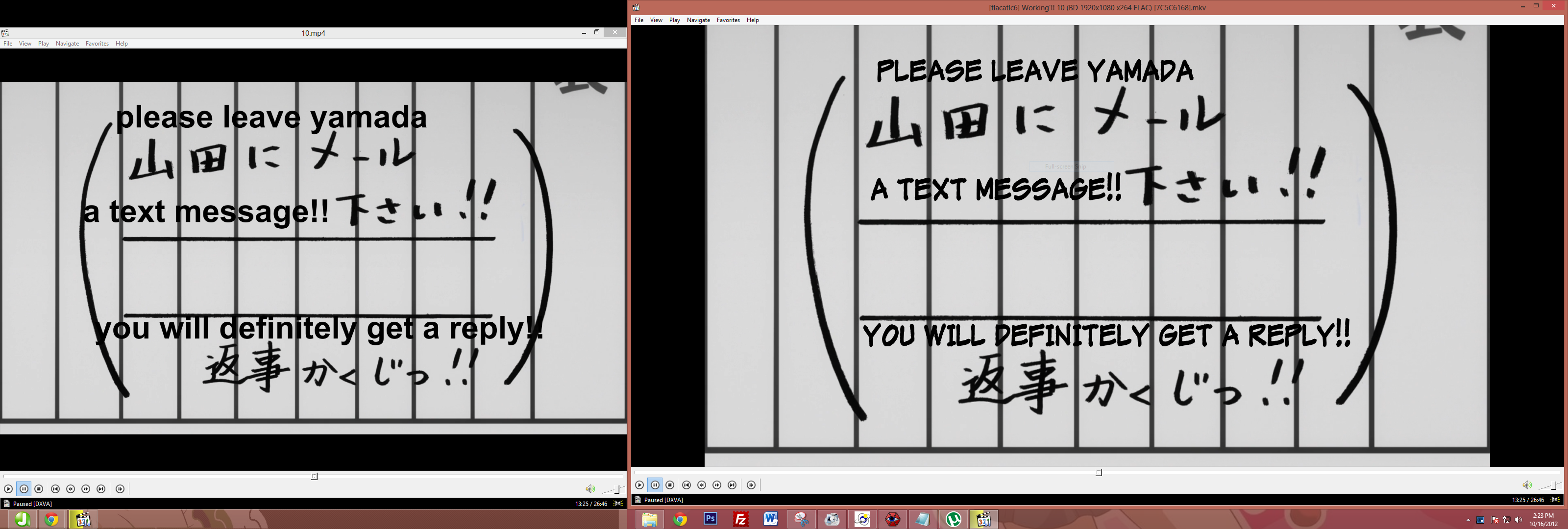

    the difference can be seen in the comparison shot i uploaded (comparison.png)

    anyone know how to actually get these out so that I can install the font?
    if you are wondering, this should allow me to then burn these subtitles into my re-encoded mp4 files while keeping the fonts.
    Thanks!

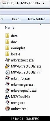

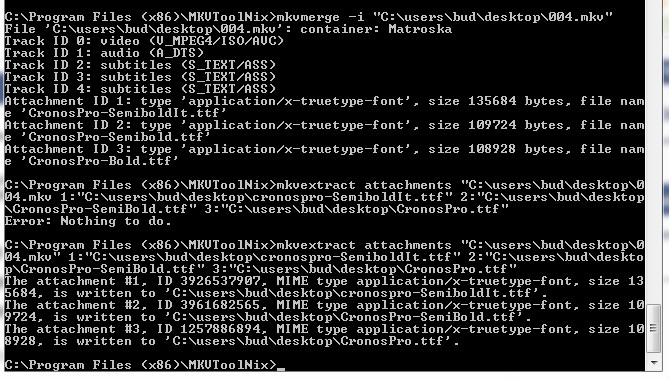

    Ok you say you want to extract te subtitles? Then forget the GUImethod since GUI does not work on mine either. Go to the Toolnix folder and you shoud have these programs there:
Name:	ScreenHunter_210 Oct. 16 17.39.jpg
    Then open a Command window (Dos Black screen) there or open itand navigate there using cd “C:\blah\blah\balh\toolnix”

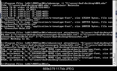

    Now run these commands (- little i for identify below):
    mkvmerge –I “c:\pathtovideo\videoname.mkv”
    You will get the ID’s of the attachments. Mine below are1,2 and 3
    Then type: MKVExtract attachments “c:\pathtovideo\video.mkv”1:”C:\pathtosave\nameoff ont.ttf” 2:”C:\pathtosave\nameoffont2.ttf”3:”Cathtosave\fontname3.ttf”
    Be VERRRYYY careful with spelling. You will notice in example below I forgot “ after the 004.mkv and it puked with nothing to do message. Mine worked, putting fonts to Desktop as noted above

  8. every time i try that, it gives me a giant list of help info and thats all
    nevermind.... typing it all manually worked... fuuuuu

  13. budman! Thank you so much !! ive been searching for solutions and trying stuff for 4 hours , just if people having trouble in commands few fixes:
    mkvmerge –I “c:\pathtovideo\videoname.mkv” should be small i ==> mkvmerge –i “c:\pathtovideo\videoname.mkv”
    MKVExtract attachments “c:\pathtovideo\video.mkv”1:”C:\pathtosave\nameoff ont.ttf” 2:”C:\pathtosave\nameoffont2.ttf” there should be sapce fater the video name befor the 1 ==>
    MKVExtract attachments “c:\pathtovideo\video.mkv” 1:”C:\pathtosave\nameoff ont.ttf” 2:”C:\pathtosave\nameoffont2.ttf”
    edit: i found a much easier way download aegisub open the .ass file and go file> attachments > select the fonts >extract
