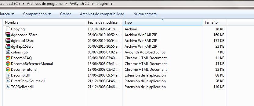

  6. If installed correctly?
    Thank you very much for your help
  7. That picture tells us nothing about whether or not you got it installed. Follow my instructions from my earlier post.

  9. Usually you keep the plugins (the DLLs) in the plugins directory, and nothing else.

    In the image posted, the only files that you would need in the "plugins" folder are the three .dll's and the "colors_rgb" file. The other files shown are not Avisynth plugins.
    The full name of the "colors_rgb" file is colors_rgb.avsi. Avisynth automatically loads "avsi" code whenever a script is run. In fact, "avsi" files are Avisynth scripts. It belongs in the plugins folder, so leave it there.

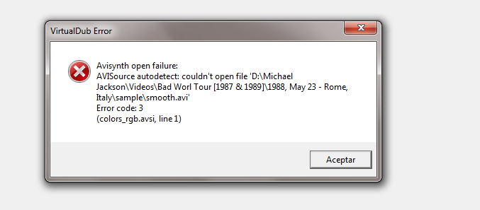

  12. I'm trying to open this project goes by another name and I get error.

    The script you have posted is not the same script referenced in the message.

  16. Remove colors_rgb.avsi from the plugins folder. It's just a bunch of shortcut names for RGB hex values. Then see if you can run your script.

    and remove it but it keeps saying the same thing, : (
    anyone know how to remove this error?

  20. It can't say the same thing if you 've removed it
    Check that you've removed it, close vdub, reopen vdub, reopen the .avs script, then post the new error message

    Thanks for posting the script. I have a question:
    The script you posted refers to this video file, opened with DirectShowSource:
    ("D:\Michael Jackson\Videos\Bad Worl Tour [1987 & 1989]\1988, February 24 - Kansas City, USA\Another Part Of Me - Kansas 88 (second night) - HQ.mpg", fps=25)
    The video file referred to in the error message is a different video file, opened with AviSource:
    "D:\Michael Jackson\Videos\Bad Worl Tour [1987 & 1989]\1998, May 23 - Rome, Italy\sample\smooth.avi"
    Why are these file names different? What script is being read by the error message? What else did you change in the script besides the file name and open command?
    Does anyone suspect that some of the characters and long path+file names might be giving Avisynth a problem?

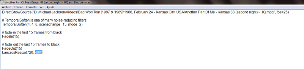

    I used this script
    DirectShowSource("D:\Michael Jackson\Videos\Bad Worl Tour [1987 & 1989]\1988, February 24 - Kansas City, USA\Another Part Of Me - Kansas 88 (second night) - HQ.mpg", fps=25)
    # TemporalSoften is one of many noise-reducing filters
    TemporalSoften(4, 4, 8, scenechange=15, mode=2)
    # fade-in the first 15 frames from black
    FadeIn(15)
    # fade-out the last 15 frames to black
    FadeOut(15)
    LanczosResize(720, 480)
    but when opened in VirtualDub I get different name and error.

    I see what you are saying. You are getting an error message from an earlier script. Are you certain you are trying a new script rather than the old script? Do you have two scripts that have exactly the same name, but in different locations on your hard drive?
    I suspect that you have not attempted to run the simple "version" test script that manono suggested earlier in post #5.

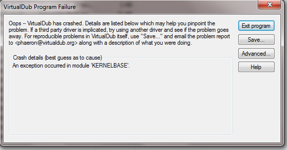

    Try opening VirtualDubMod and see the error I have.
    Look at the error when I try to open VirtualDubMod

    I'd have to say that you might have a problem with all three applications. If you have run the Avisynth installer more than once without first removing the early version, that can cause problems as well. The same would be true with VirtualDub and Mod.
    VirtualDub and VirtualDubMod have an uninstaller inside their main folder. The name of the file is auxsetup.exe. Run that file and tell it to remove your settings. There is no real unstaller for VirtuaqlDub, but auxsetup.exe can remove some registry settings. Then, delete the VirtualDub folder and the VirtualDubMod folder. To reinstall, unzip the original downloads, but install them into a new folder on a different drive. I see you have a "D" drive. re-install them on your other drive instead of the original "C" drive; the actual drive doesn't not matter.
    You can do the same with Avisynth, but it has an uninstaller in Control Panel. If you reinstall it, install to a different drive.
    Vy the way, if you have Windows 7 install the 32-bit versions of these programs. There are 64-bit version available, but many of their filters don't have 64-bit versions.
