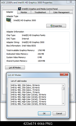

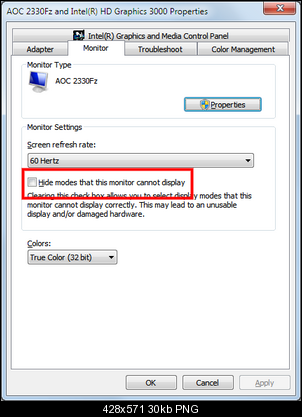

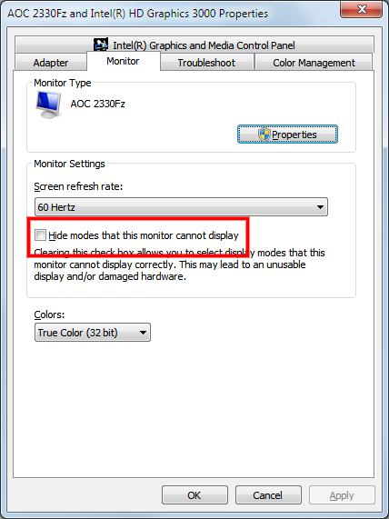

    It's possible to get the desktop down to 640x480: Go to the Monitor tab of the Advanced Video Settings and disable "Hide modes that this monitor cannot display".

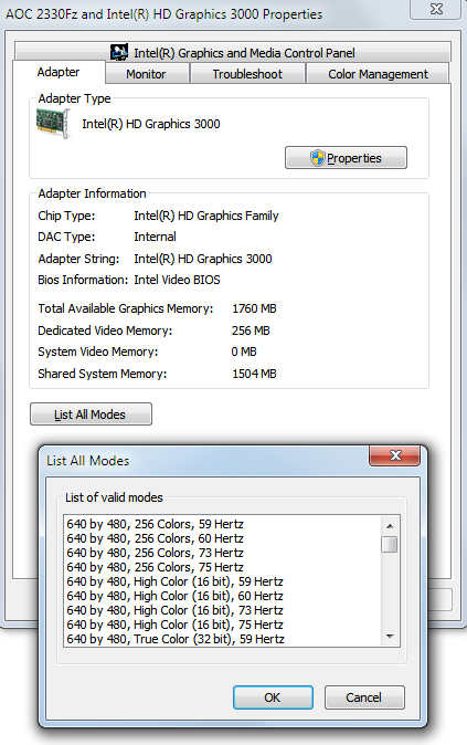

    Then go to the Adapter tab and select "List All Modes". You'll see 640x480 settings there.
    Be warned many Windows dialogs will not fit on a 640x480 display. It can be hard to close dialogs because the buttons will below the bottom of the screen.
