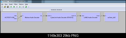

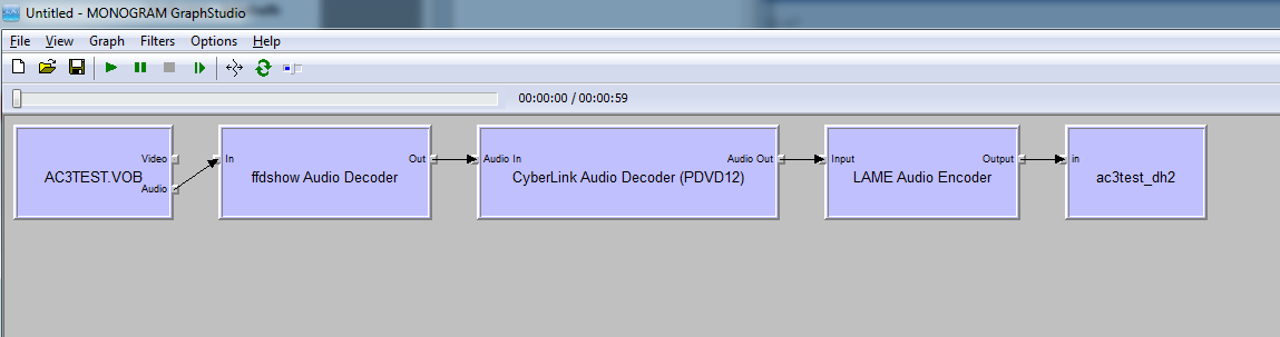

  6. Yup what I'm looking to do is take the result of the dolby headphone processing and encode it as a binaural soundtrack. I found ffdshow's hrtf pushed everything back and the dialog seemed funny. This however was with full size headphones and I believe it's meant for IEMs. I will however be using IEM's for listening to these encodes. I may have to do another comparison. Convolver looks very interesting I actually hadn't heard of it before. Looks like it can also be used for room eq.
    For the moment the solution I'm using is encoding using the filter path in this graph:
    And then using mkvtoolnix to mux the new dolby headphone mp3 track into the mkv. Not exactly an elegant solution but it does the job it appears. For some reason LAME audio encoder doesn't seem to follow the vbr profiles I set in graphstudio so I'm stuck using 320 CBR which seems excessive but I guess space is cheap these days.
    For anyone who is interested in doing this you need to swap the channels as the Cyberlink decoder expects them differently to standard. I refer you to this thread on the zoomplayer forums for how to do so. Done correctly you should be able to encode dts, ac3 or any other surround format ffdshow can process to dolby headphone.
    Edit: the result of the above:ac3test_dh2.mp3
