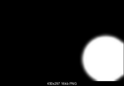

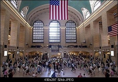

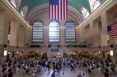

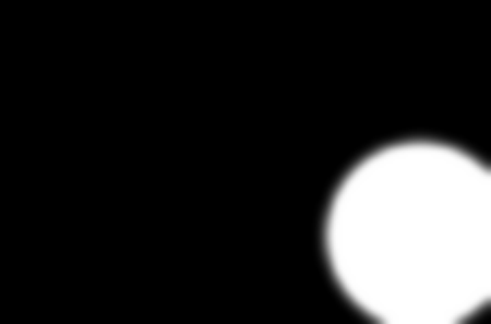

  4. Since the background in your image was fairly symmetrical I used a horizontally flipped image as an overlay. I quickly built a mask in a paint program. Then used the following script to overlay the flipped image onto the original:
    src=ImageSource("1qn1xs.jpg")
    flipped=FlipHorizontal(src)
    mask=ImageSource("mask.png")
    Overlay(src, flipped, 0, 0, mask)
    result:
    mask:

    Don't freak out, OP!
    That example above is just the very essence of what you need to understand. The actual implementation in your NLE is much more friendly.
    The concept is, white is "high" and black is "low", and the NLE will blend in the gradient. The gradient is the fuzz around the circle. To produce a soft blend, rather than a harsh hard circle.
    Just think about it for a while.
