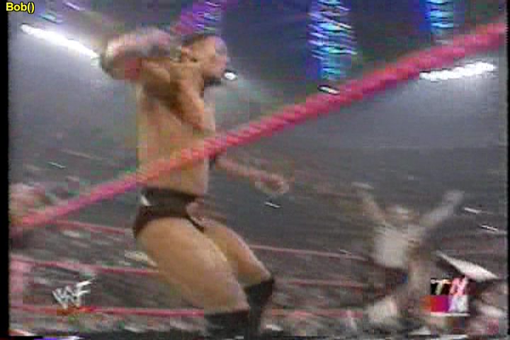

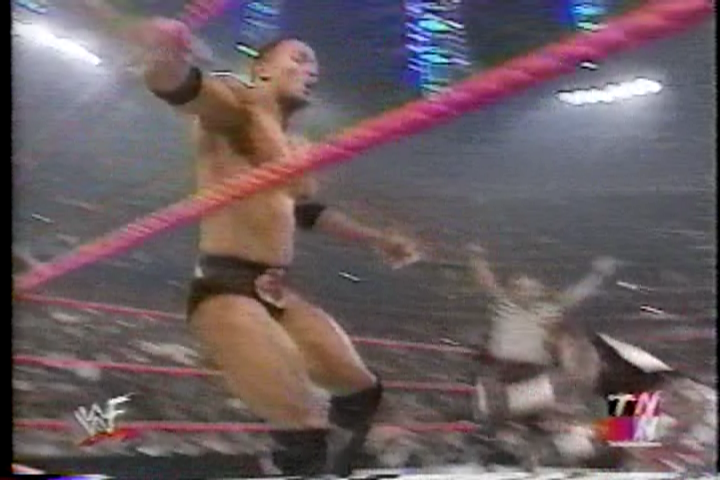

    F347-original-interlaced (below, unmodified capture from the source mpg):
    There are obvious macroblocks on the big guy's bare leg, near the knee, and one at chest level. Some less obvious blocks along the left border and along the length of the diagonal red rope. Clumped-up grainy stuff with chroma noise in dark areas and around the white lights on the right. Then there's color shift and bleed, mostly oversaturated red. Also, note the white ghost trails of the whitish figure on the right. Strong interlace combing and poor motion control. Most of this junk isn't "noise", it's low-bitrate artifacts and the usual tape playback problems.

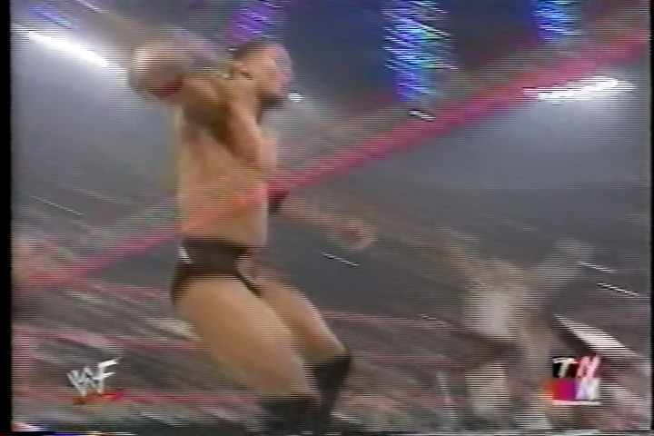

    F347-MCTD-interlaced
    McTemporalDenoise(settings="medium", interlaced=true, deblock=true, useQED=false, quant1=40, quant2=80)
    Macroblocks softened a bit but still there. Clumpy grain smoothed a little, fine detail in the audience is disappearing. Edges visibly cleaner. Basically, the image has been smoothed but most artifacts are still there.

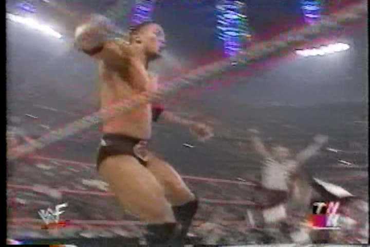

    F347_MCTD_Bob
    Same MCTD (interlaced=false) but Bob'd first, then reinterlaced. Results similar to above, but more fine detail is retained.
    [Attachment 14246 - Click to enlarge]

  10. Originally Posted by sanlyn View Post
    If you Bob() you'll see that both fields are full of macroblocks. You'll also see that all the even fields have screwed up chroma (a mix of the field before and the field after).

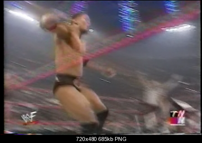

    F347_QTGMC_DeBlock
    QTGMC(preset="slow")
    DeBlock(quant=60,aOffset=8,bOffset=8)
    Most of the lesser blocking looks clean, but the big blocks are now big blurs and contours remain distorted. Images in which this distortion occurs illustrate the basic problem: the encoder didn't just create macroblocks, it literally deformed parts of the image.

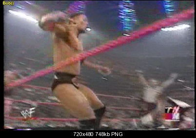

    One field of the original video (simple Bob()):

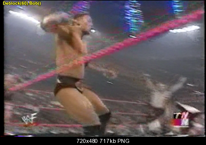

    Deblock(60).Bob():

    If you zoom in on the original video you'll see that most of the frame has blocky artifacts. The frame that was deblocked while interlaced has some of the blocks smoothed out but has more jagged edges and further screwed up chroma channels. The frame that was bobbed before deblocking has most of the blocks smoothed away and the chroma isn't contaminated with chroma from the other field.
    Again, this isn't my suggested algorithm for deblocking interlaced video. Simply a demonstration of why you need to deinteralce before deblocking. A simple Bob() results fuzzy video with jaggies, not suitable for production. But it's fast and easy for this demonstration.
