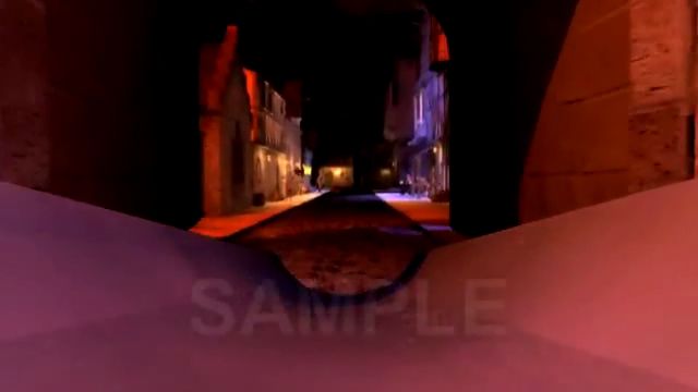

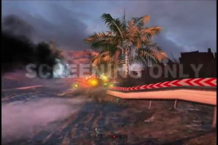

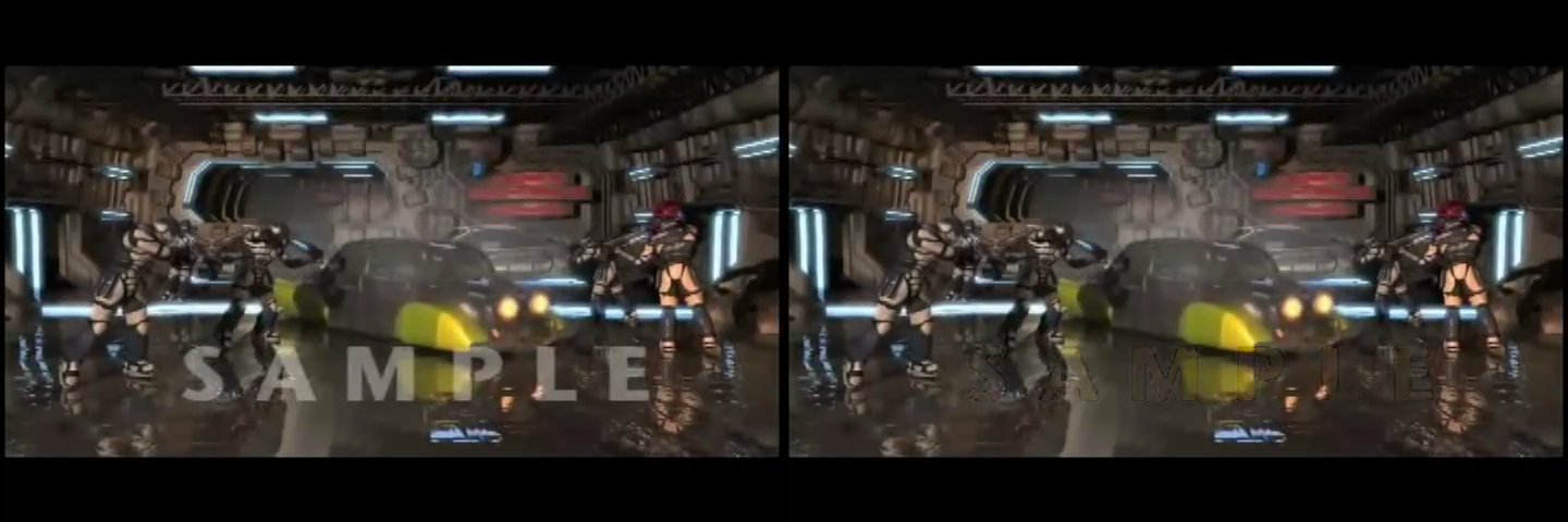

    Anyway, here are screen shots of four different videos with different types of watermarks.

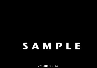

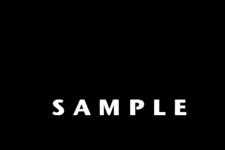

    - make a still image from part of the video where the watermark is on a black background
    - clean up in photoshop/GIMP, increase the contrast so the lettering is white and the background is completely black:
    If there aren't any frames where the text is on a clean bg, you'd need to recreate the overlayed text/logo by hand. Accuracy is important here.

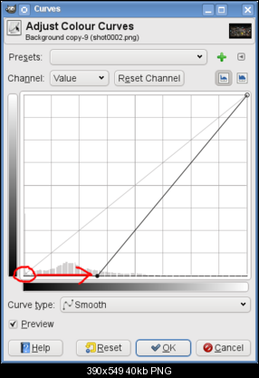

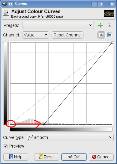

    Use the curves colour correction tool to reduce the black level back of the upper layer (not the mask) by dragging the bottom left point to the right. A straight line should be maintained:

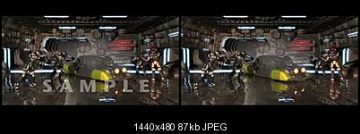

    Which will give you something like this:
