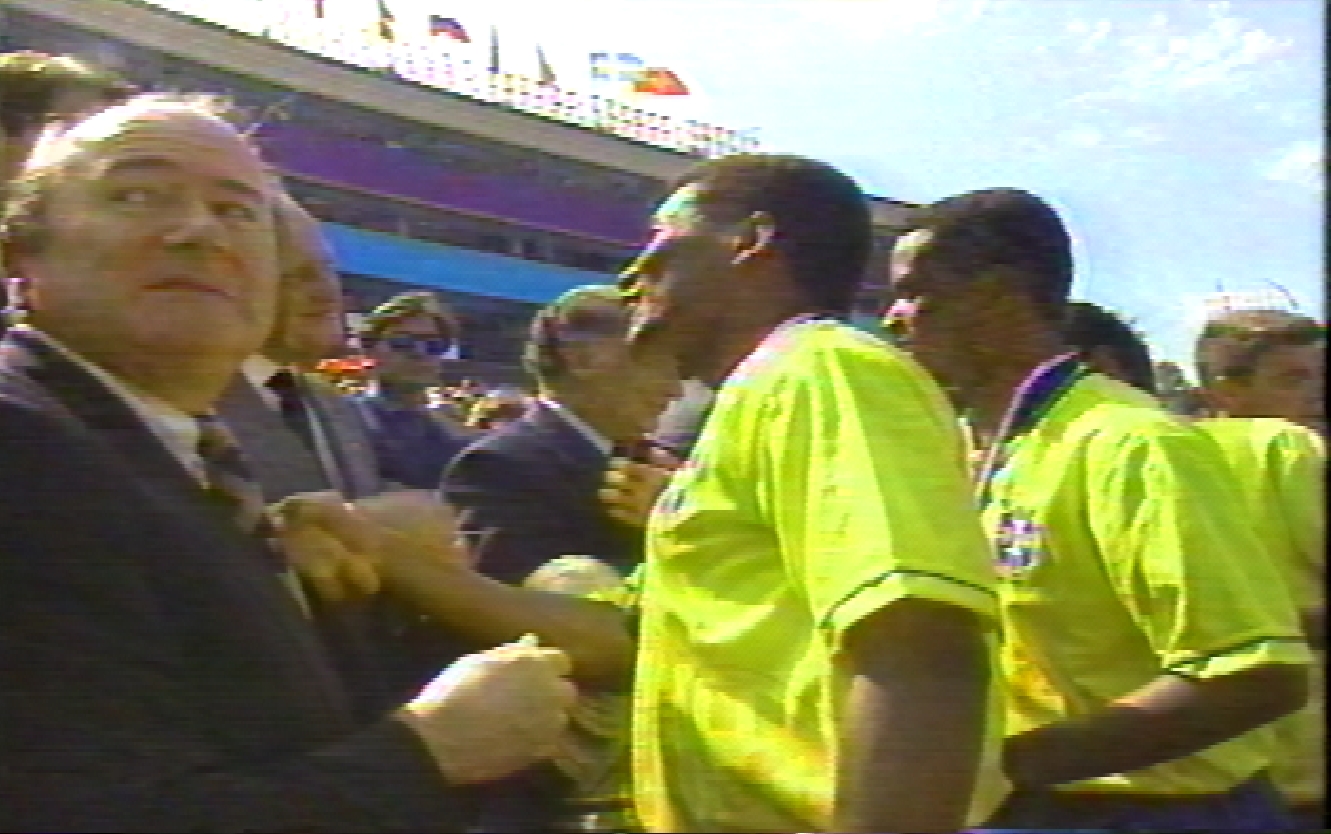

    i have one aiw 7500 ve pci theater 200 , finally i get working ,
    but quality i cant full me yet, i had a lot of cards with me pvr 150-250-350, colossus, avermedia 1500, digging online 250-350 are good ones, digitalfaq suggest aiw for conversion, after check results, colossus and 250-350 are on top, because they eliminate noise, on vhs, meanwhile aiw 7500 give a crystal impression on video when im watching it, more detail , but after recording i cant get same result, i try with mpeg and avi via aiw software 8.7 like digitalfaq manuals suggest for both kind of formats , i do too with virtualdub.
    vhs is jvc hr 9111u , well for now i only need help if aiw 7.5 its best one for it
    sorry if my english is bad not is my native lenguague.
    sample picture,
    aiw 7500---mmc 8.7 , avi 15mb/s, composite, vhs jvc hr 6900

    It is usually difficult to analyze video problems using still images. So this reply will be somewhat incomplete. It would be useful to include more information about the video from which the image was made. Is the video in a compressed AVI format, a lossless AVI format, an MPEG? I assume from your post that you captured using MMC, but I don't know what recording format was used.
    The image looks like an overexposed photograph; some of the colors are over saturated, but some look under-saturated. Many of the brightest highlights are too bright and appear to be burned away, while the darker areas look grayed and thin. Did you set any MMC filters during the capture? The MMC utility was a good convenience in its day, but it would be better to capture VHS to AVI with a lossless compressor (such as huffyuv) using VirtualDub. I own a 7500 AIW and I still use it that way for VHS capture, especially for old tapes that will need some repair. I was never completely satisfied with MMC capture, so I haven't installed MMC for several years.

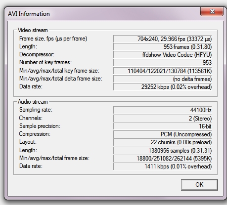

    here some information

    The info is helpful, although a short sample piece of actual video would tell us even more.
    The 704x240 frame size is not DVD compliant for MPEG2 video, nor is the 44K audio audio sampling rate (it should be 48K). The output from your VCR would be a display frame of 640x480 interlaced. Many would capture such VHS at 704x480 or 720x480, while some would capture at the display size of 640x480.
