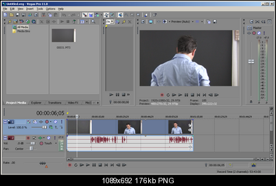

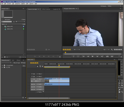

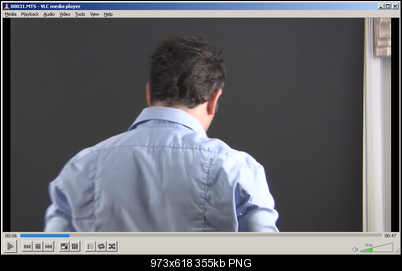

  9. I can't see any problem with file
    I can play in VLC version 2.0.2 no problem with colors
    I can play and edit in Sony Vegas Pro 11 64bit
    also I can play and edit in Adobe Premiere Pro CS6
  10. There is no problem playing or editing the file, the problem is with the colors. They are much different than the original recorded video colors. Do you see the shirt as blue or purple-ish?

  12. Yes, Sony Vegas Pro, latest VLC and WMP. Apparently you get the same picture with me though. So, it must be the file. But then if it is the file, then how come it plays perfectly when I play it back directly in the camcorder?

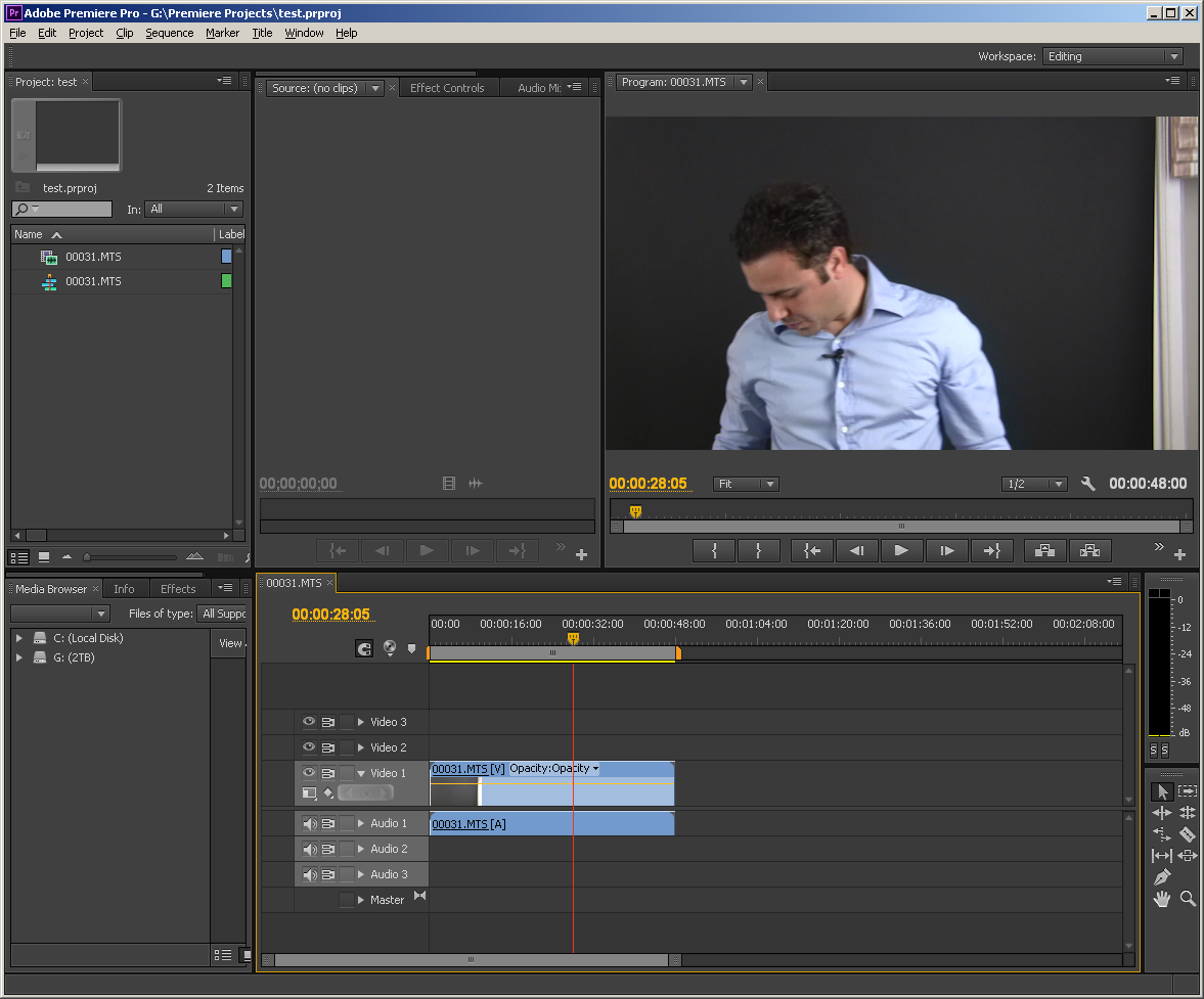

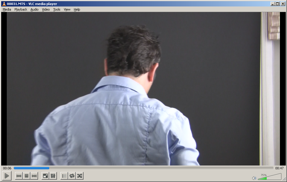

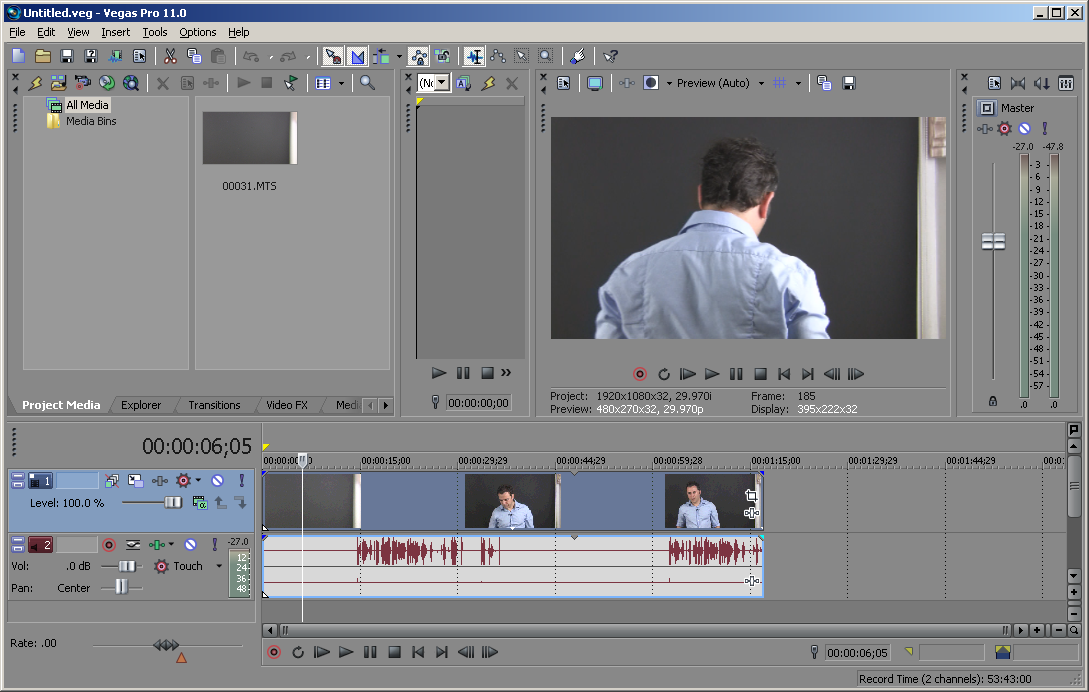

    All of the images you posted have the same color balance; they all look alike (which leads me to ask, why did you post images of entirely different frames?). All the gray backgrounds are the same, except on CS6 they are darker -- but since the images are not all from the same frame, it's impossible to draw any conclusions about that.
    You are aware, I think, that all monitors require calibration for video work. Don't assume that just because they are "digital", they all display in the same way. They don't. It's rare to find a properly calibrated monitor out of the box. CS6 has extensive documentation on that subject, as well as various settings for viewing and color correction using various color spaces and matrices depending on the color system used by your video and your monitor. I would imagine that Vegas has similar features. VLC, like most media players, has no proper color balance adjustment except for some primitive Tint, Saturation, and Brightness/Contrast controls. There are various hardware/software packages, test patches, and gray ramps available for testing and adjusting displays. It is far too extensive a subject to cover here. There will not be much variation in screen captures anyway. The Windows clip board (usually) copies the source image with no modification.
    BTW, the VLC and Vegas images are telling me that the brightest parts of the blue shirt are clipped and beyond the standard RGB range for TV video (for PC playback they are within range, but they look somewhat clipped to me), and your black levels seem a bit high. But I don't know what kind of processing was done on the video.
    Your camera likely has some sort of IRE record and playback settings. They might not match the IRE standards of your PC.
