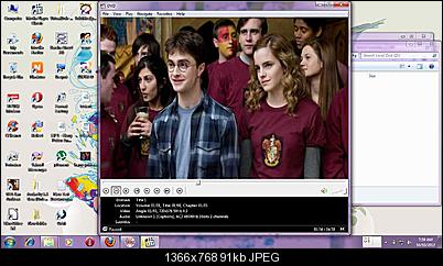

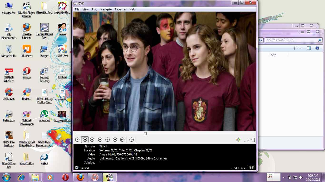

    Well here is more oddness. I of course did try that method of playing the DVD video in MPC and VLC, but neither would show the subtitles (even after selecting the subtitle track), but apparently a Subpicture.SUP could be ripped off it (And I wasn't playing just the .VOB, I was playing the whole folder) Click image for larger version

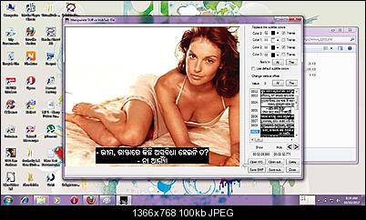

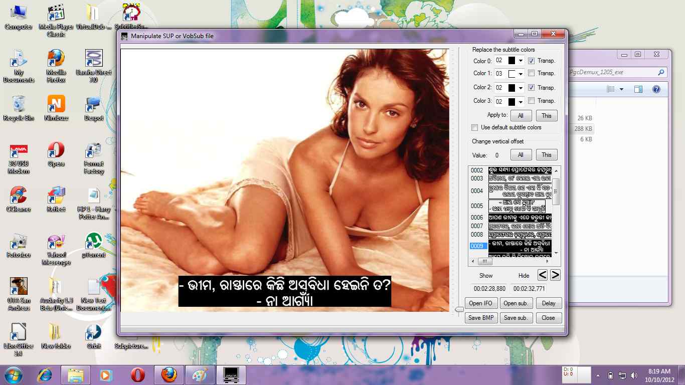

    And that's not the end of madness! I used MuxMan to produce the DVD files again as I had deleted them, and this time I just used another 720X576 image as video source. Shouldn't make any difference, right? But it did! This time, the Subpics.SUP had all the dialogues, however the rogue ones which were missing earlier still look different with white text on opaque black background unlike others which are on transparent background Click image for larger version
ID:	14199. See, one of the rogue dialogues is selected. However I can live with these awkward ones, something is better than nothing. Thankfully I didn't have to use DVD SubEdit to replace the images manually.

    You should be able to make the background color for all the subs transparent in DVDSubEdit.
    And, as I think you already know, once you convert the SUPs to VobSubs, you can make the 'final' colors whatever you like in VobSub Configure.
