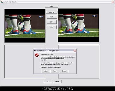

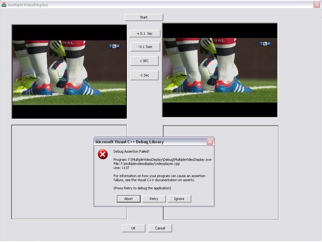

    But i found another issue . Let me clarify my actual issue
    I have four CStatic based window in which i am display the video user can seek 0.1 second wise, seconds, minutes and hour bases. I can able to see the video on the first two CStatic window, rest of the two window get a black screen with a message debug assert failed message.
    The code from where the debug alert message is thrown
    pause()
    if ( m_pMediaControl )
    VERIFY ( SUCCEEDED (m_pMediaControl->Pause()) );
    I have attached the screen shots of my sample applications for your reference.
