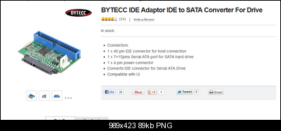

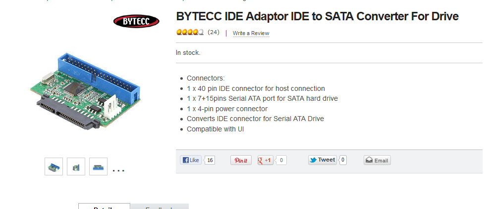

    hehe no simple cable/connector can hook usb to sata port. what you need is to open the drive case and use something like this powered pata to sata converter and then you can use a cable from the drive to the motherboard.

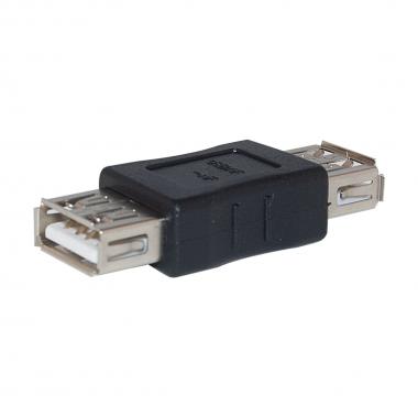

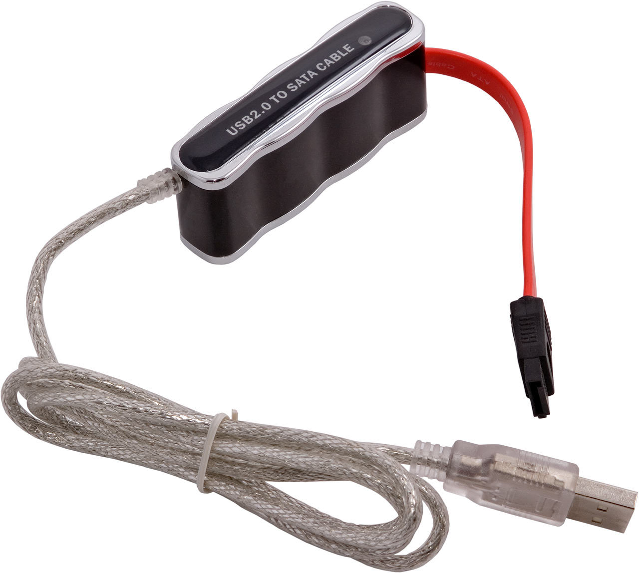

  22. I'm pretty sure that he really only needs to buy the following two things, in order to accomplish his goal:
    USB A/A Coupler:

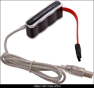

    and a USB to SATA Adapter:
    Assuming that he can get a USB to SATA Adapter that can work backwards
    (SATA Plug connected to MB, instead of directly to a HDD).
    Ya might want to write the manufacturers of USB to SATA Adapters, and ask them if their products support that kind of a hookup, before ya buy.

    those are called usb to sata adapters BUT they only work in the other direction. they connect to the sata drive and plug into a usb port on the computer.
  24. Originally Posted by aedipuss
    Those are called usb to sata adapters BUT they only work in the other direction. they connect to the sata drive and plug into a usb port on the computer.
    I was afraid of that.
    If users are restricted to preforming fresh installs of Windows on only IDE or SATA ports, then he'll have to either buy a new enclosure with eSATA, or play musical chairs with the HDDs already in his PC.
    At least there's that registry edit, that ya'll mentioned earlier, that'll trick Windows into booting from usb, once it's installed.
    Then again, there's also HDD cloning software to consider...

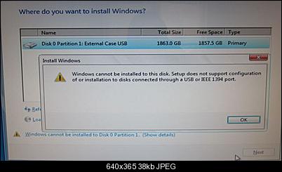

    Originally Posted by nic2k4 View Post
    You probably need to do an install to the USB drive for it to work. .
    Not possible it says..
