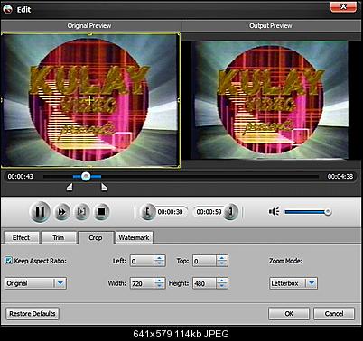

    First of, I must remind you that I'm a non-techie so bear with me. And apologize I cannot show the faces of those in the videos. Anyway, there is an opening credit that hopefully was a perfect circle when recorded. And remember that the images on the three sources, DVD, converted MP4 and those posted in YouTube, look the same when viewed in my monitor. They "seem" distorted.
    1. Here's the original setting when converted to MP4 when people complained they looked skinny.
    Input 720x480 cropped full image, output setting was 720x480 (zoomed "Letterbox")
    https://vimeo.com/50909590
    2. Based on Jagabo's explanation/suggestion to cut 16 pixels - input cropped to 704x480, output setting was 640x480 zoomed "Full"
    https://vimeo.com/50909592
    3. Again based on Jagabo's suggestion to cut 16 pixels but this time I want the full image intact.
    Input 720x480 cropped full image, output setting was 656(640+16)x480 zoomed "full".
    https://vimeo.com/50909591
    I believe what I said before that 704x480(zoomed "full") to be my output setting will be a bit wider than the correct DAR.
    Guys, if the above does not make sense to you, bottom line is, I just want to know what output setting will display the correct DAR if I do not want to cut pixels from the sides, given my sources. I'm thinking 656x480 maybe nearest to the correct DAR?
    Thanks.
