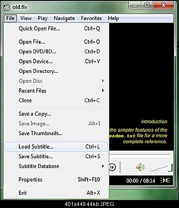

    Not sure I know what you are asking but If you have a subtitle file you want to use, load the video, hit stop and a subtitle load selection can be made as below.

    Otherwise, if you have Directvobsub installed, MPC will automatically pick up subtitle file if its in same foler with the same name as video (e.g. video.avi & video.ssa). I may have mistaken what you are asking but I saw noone answered in a few days so I gave it a shot.
