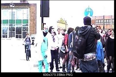

    Wasn't sure of how best to title this thread and hope I've posted this in the correct forum, but anyway.
    Shot some footage a while back using an old Sony 8mm Handycam.
    Unfortunately, when I came to transfer the footage onto my laptop for editing, I found that that I hadn't quite got the "brightness" set right on the camera when I fillmed it, so some of the footage looks overexposed/too bright.
    Is there a way of colour correcting/altering the brightness on my image editing software to try and improve the picture so it isn't so bright and blurry? I'm going to be using Corel Videostudio 12 to edit the footage, although I also have access to Magix Media Edit Pro if that's any better.
    Tried doing some tinkering with Corel's colour correction feature, but being a complete newby, it just made the brightness look differant, as opposed to better.
    Any tips? I've attatched an image below so you can see the problem.
    Thanks in advance!

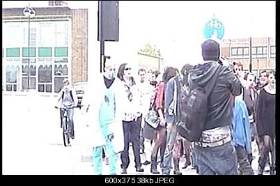

    This is outside the realm of Videostudio, but I will mention it anyway as an alternative. I've used the Tweak filter in AviSynth with a negative value (-35) for "bright" and a changed value for "cont" (I used 0.8 here) to make some improvements something like in budwzr's example, but you can't expect miracles. I sure wouldn't call what I got in the end as perfect, but it did look a heck of a lot less bright and it did restore some details.

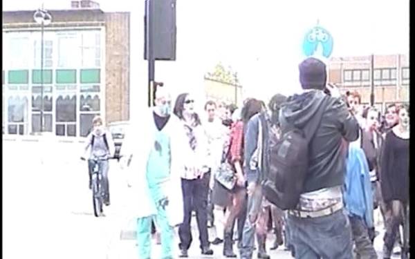

  8. A little more detail in the bright areas might be recoverable with the original YUV data. Gamma 0.45:

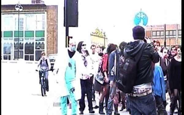

    HDRAGC plugin for avisynth can be tried as follows
    invert().hdragc().invert()
    A little known fact about the hdragc plugin is that it can be used for bringing out details in overbright frames, when used as above. (The plugin was designed to bring out details in dark areas. The invert() changes bright to dark and dark to bright)
    Adjust the min_gain and coef_gain parameters for hdragc to optimum level.
  17. when using the hdragc technique, you have to either use the shift parameter, or use levels to bring Y' <=235 before applying hdragc , otherwise Y'236-255 will get crushed when you invert it before hdragc gets applied

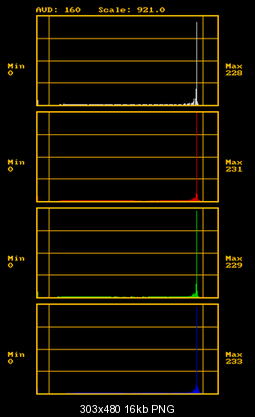

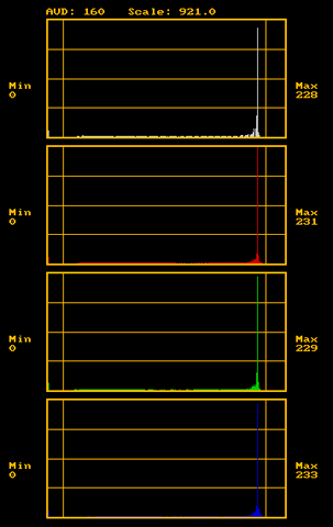

    Lost cause. Hard clipping, from the lower midtones all the way up. The peaks at the right show no data, period. Nothing up there to retrieve.

    Well, that's a histogram showing the color channels.

    Shows hardly any video data across the length of the graph, and the the sharp, sky-high peak and cutoff at the right of all 4 channels (luma + colors) shows the camera's recording system was unable to encode anything above a certain brightness level (clipping). In other words, there's no data to retrieve. If you lower the contrast level (which I already did, in YUV) all you do is move the darker colors to the left and obscure dark detail (crushing), and the only thing the bright right-hand peak will do is move to the left (get darker). It will remain a skinny sharp peak, just darker.
