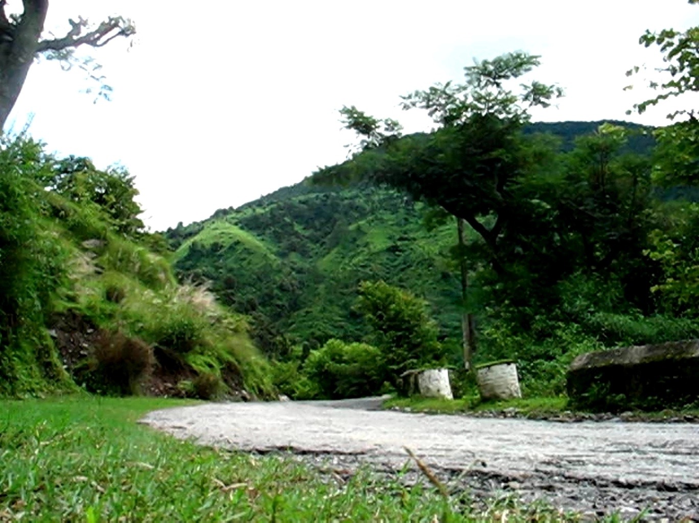

    I allready knew while filming that there was dust between my lenses and the result is that a fixed white stain appears in the middle of every video I shot. I tried a lot of different tricks, but so far no luck. At the moment I'm using Avysynth, but I can't figure out how to remove this white stain. Does anybody have an idea how I can fix this?

  2. Have you tried any logo removal or inpainting techniques /filters yet ?
  3. No, so far I only tried the DeSpot filter (which causes the application to crash) and the RemoveSpot function. How can I use the logo removal or other inpainting techniques/filters?

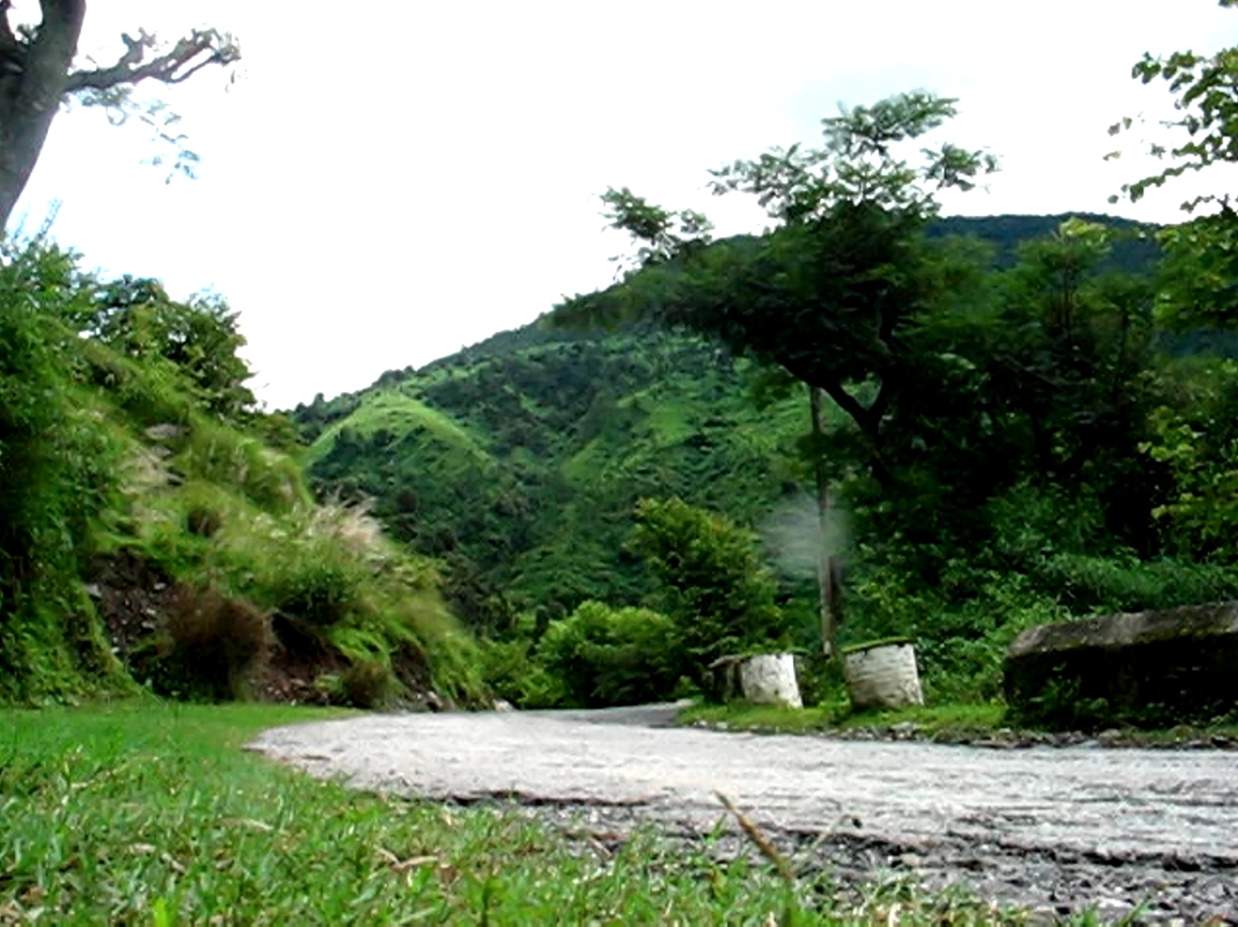

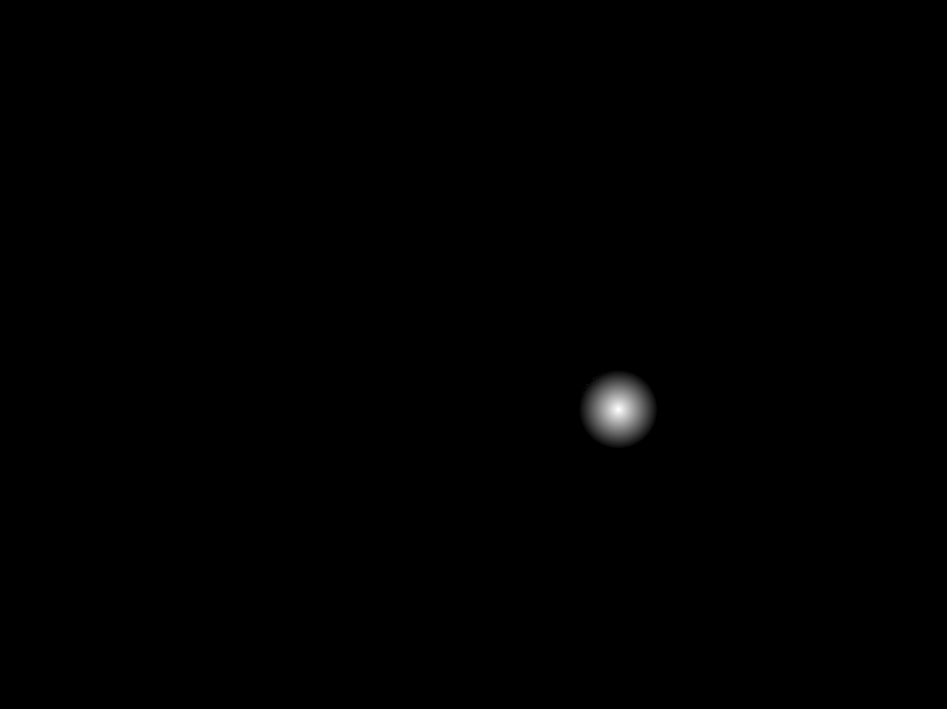

  4. A video sample would have been better. You'll have to play around with the ColorYUV adjustments for other shots but try something like this:
    src=ImageSource("Video.jpg").ConvertToYV12()
    mask=ImageSource("mask.png").ConvertToYV12(matrix="PC.601").ColorYUV(gamma_y=200, gain_y=100)
    dark=ColorYUV(src,gain_y=-140,cont_u=100, cont_v=100)
    Overlay(src,dark,0,0,mask)
    Interleave(src,last,dark) # for comparison
  5. Originally Posted by Biddy View Post
    DeSpot , RemoveDirt, RemoveSpots etc... those types of filters only work for non-persistent defects (the spots are sporadic and don't occur on adjacent frames)
    There are a bunch of guides and filters, some work better for opaque, some for semi-transparent
    http://avisynth.org/mediawiki/External_plugins#Logo_Removal
    e.g. delogo , vdub
    https://forum.videohelp.com/threads/221665-Removing-Logos-using-DeLogo-vdub-filter#1376335
    e.g. msu
    http://www.compression.ru/video/logo_removal/index_en.html
    e.g xlogo
    https://forum.videohelp.com/threads/273109-Remove-an-opaque-logo-using-Xlogo-in-Avisynth
    e.g. rm_logo
    http://forum.doom9.org/showthread.php?t=134919

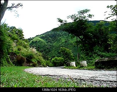

  6. You can play with layer blend modes (similar to photoshop layer blend modes) to get slightly better results.
    You might have to make adjustments to the mask, as it's hard to tell with a still jpeg. As jagabo said, a video sample would have been better
    If it's primarily a "white" spot with some transparency, you shouldn't have to make any major adjustments per scene or when there are lighting and exposure changes- unless you clip, crush, or overexpose in that scene
    This is from jagabo, just slightly modified
    mask=ImageSource("mask.png").ConvertToYV12(matrix="pc.601")
    dark=src.levels(0,0.4,255,0,255,false)
    Overlay(src,dark,0,0,mask, opacity=1, mode="softlight")
    You can do this in NLE's or compositing applications like AE, blender. IMO they are easier to use and make adjustments , have better mask tools , feathering, and compositing filters for this sort of thing

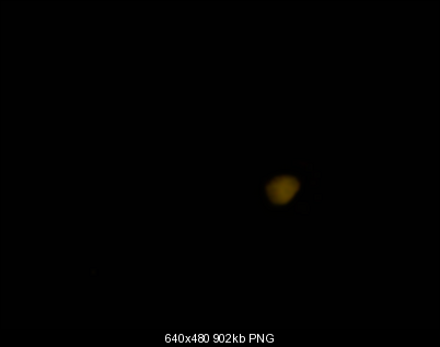

  11. That's a much better sample. What I did earlier doesn't work well in some sections. poisondeathray's modification (with a little more modification) works better.
    src=AviSource("MVI_0030.AVI")
    mask=ImageSource("mask.png").ConvertToYV12(matrix="pc.601").ColorYUV(gain_y=100)

    If you can get the spot with a black background (I noticed there were a few others too) you can build a better mask and it will work better. The spot still showed up a fair amount in some parts of the video. Playing around with the mask and parameters may improve those areas. I built the mask from frame 454.

    Yes, there was no frame with a nice black background behind the entire spot. I used the best I could find in the clip but ended up losing some of spot. Ie, I took frame 454 and painted everything around the spot black, including a little bit of the spot because there were image elements there.
