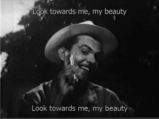

  11. To create a toptitle for SSA subs, just add the 'a6' style to the line:
    Dialogue: Marked=0,0:00:00.23,0:00:03.27,*Default,,0000,0000 ,0000,,{\a6}Look towards me, my beauty
    If using SubStation Alpha, highlight the line in question and hit the 'Style Override' button at the top.

  13. Originally Posted by Valerc View Post
    But first donīt you need to define that style a6 at some place?
    Did you try it? The 'a6' is basic SSA syntax.
    And also, how's the program which will add the subtitles to the video going to know what a6 means?
    It's understood by any player and program that reads SSA subtitles and the VSFilter (VobSub/TextSub). For example, below is a picture from that same hardsubbed video. The lower sub was already there. The upper sub I added in like this after changing my SSA sub for the song to make it a topsub as described in my earlier post:
    LoadPlugin("D:\AviSynth Stuff\Dlls\VSFilter.dll")
    AVISource("I:\Indian Music Videos\Movies\12 O'Clock\Dekh Idhar Ae Haseena.avi")
    TextSub("I:\Indian Music Videos\Movies\12 O'Clock\Dekh Idhar Ae Haseena.ssa")
    I see the sub on top when opening the script in VDub, or when playing the script in MPC-HC.

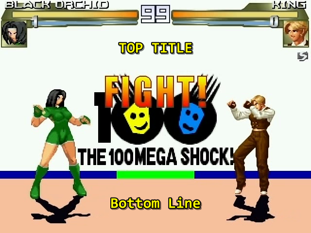

    OK, I am somewhat late, but let's hope it's not too late for you
    Here goes a sample SSA file, of course you'll have to change some values according to your needs:
    [Script Info]
    ; This is a Sub Station Alpha v4 script.
    ScriptType: v4.00
    Collisions: Normal
    PlayResX: 640
    PlayResY: 480
    Timer: 100.0000
    [V4 Styles]
    Format: Name, Fontname, Fontsize, PrimaryColour, SecondaryColour, TertiaryColour, BackColour, Bold, Italic, BorderStyle, Outline, Shadow, Alignment, MarginL, MarginR, MarginV, AlphaLevel, Encoding
    Style: BottomTitles,Consolas,36,65535,65535,255,0,-1,0,1,2,2,6,40,40,400,0,1
    Style: TopTitles,Consolas,36,65535,65535,255,0,-1,0,1,2,2,6,40,40,80,0,1
    [Events]
    Format: Marked, Start, End, Style, Name, MarginL, MarginR, MarginV, Effect, Text
    Dialogue: Marked=0,0:00:02.00,0:00:05.00,BottomTitles,NTP,0000,0000,0000,!Effect,Bottom Line
    Dialogue: Marked=0,0:00:02.00,0:00:05.00,TopTitles,NTP,0000,0000,0000,!Effect,TOP TITLE
    And below is the result in VirtualDub:
