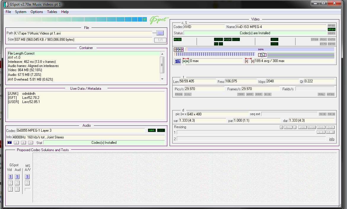

  4. Thanks for the replies. I captured the VHS using my Hauppauge 950Q USB tuner using Golden Video. Its an AVI, see attached image. Im actually not new to the forums, I had to make a new account because i didn't remember my password and it was attached to an old email address i no longer have access to.
