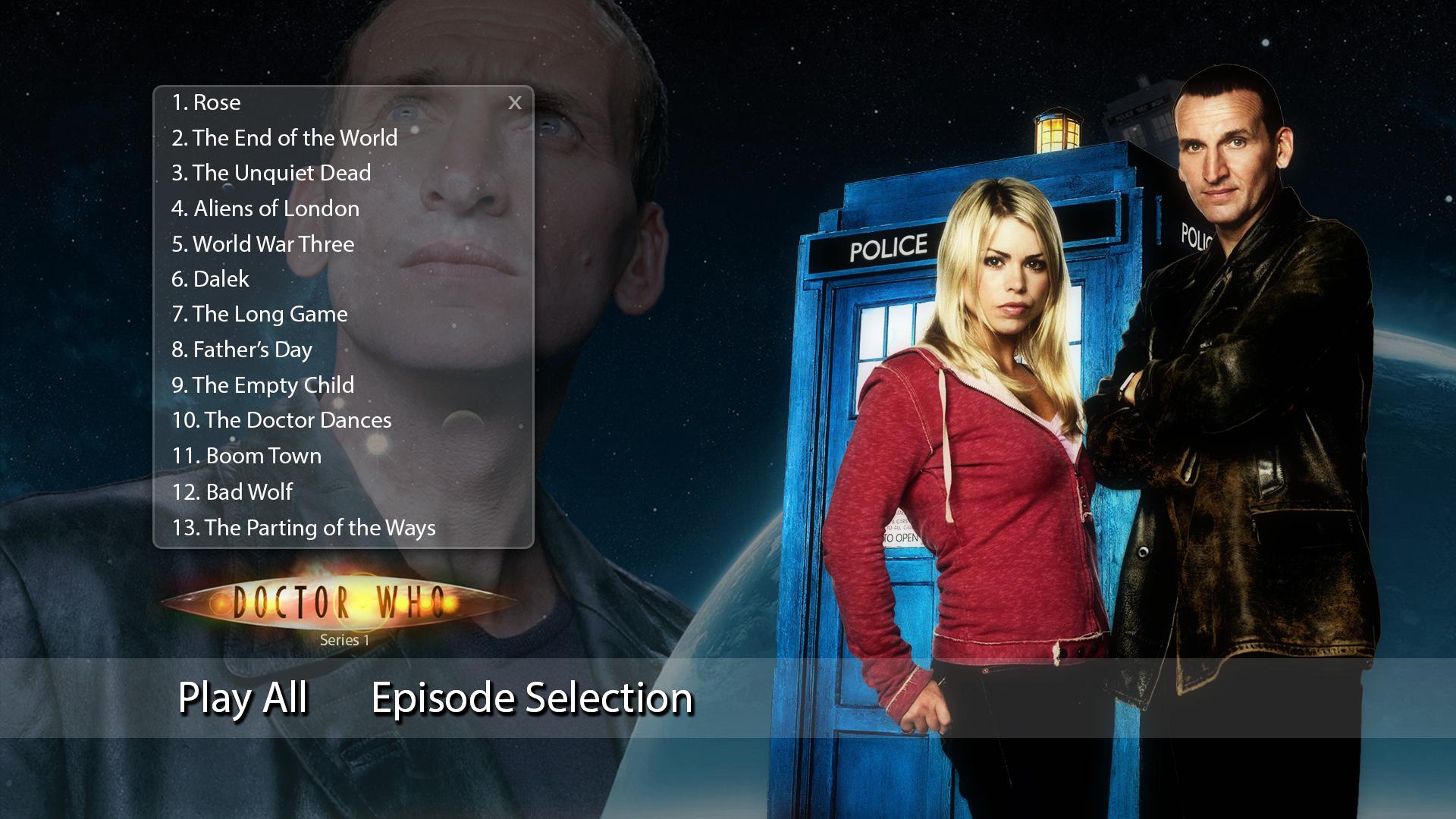

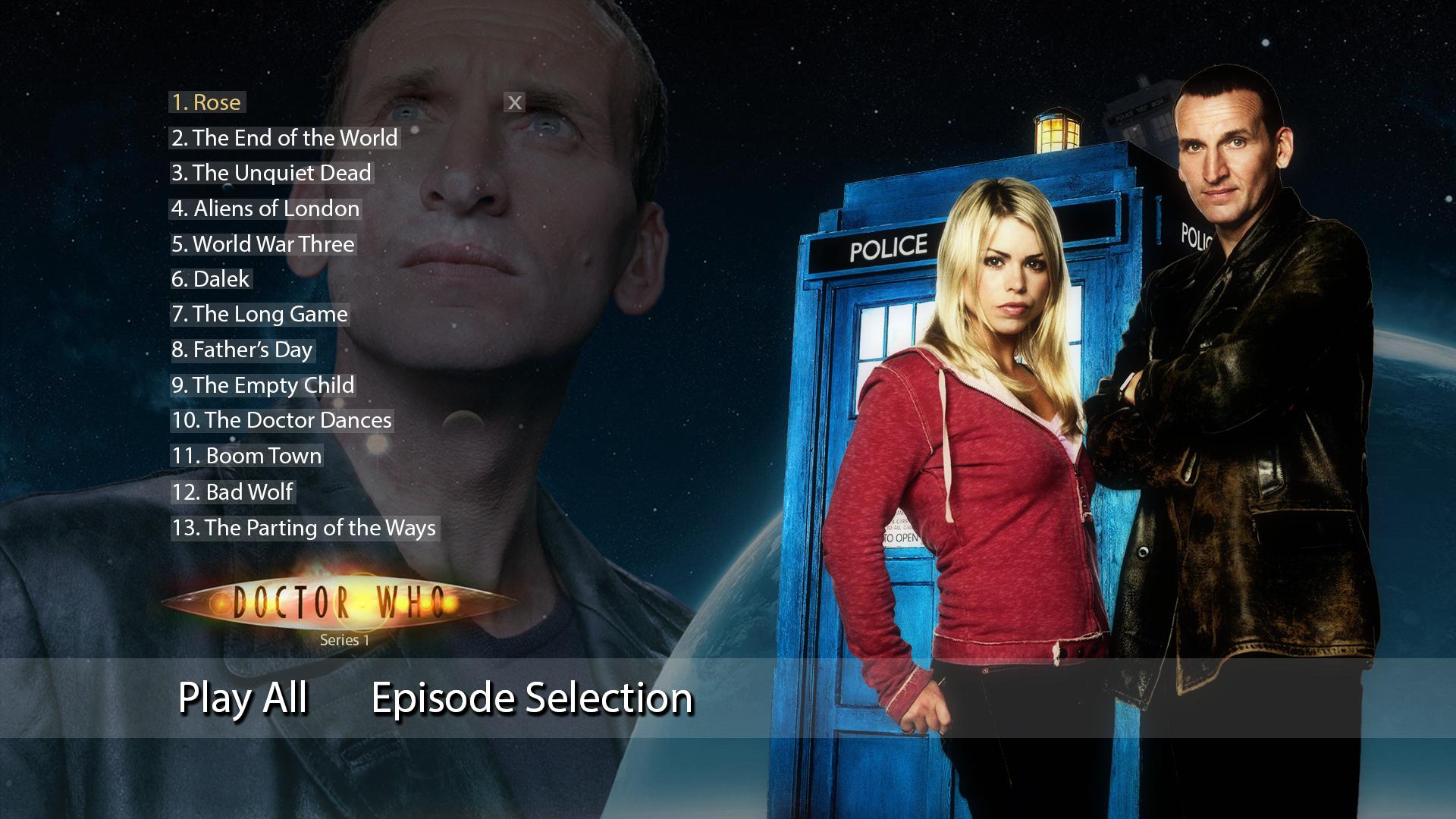

I'm using a 2 page menu. When the user selects "Episode Selection" the menu loads page 2, which is a box that contains a list of all the episodes on the disc. These are what the menus are supposed to look like:
click the images for higher resolution

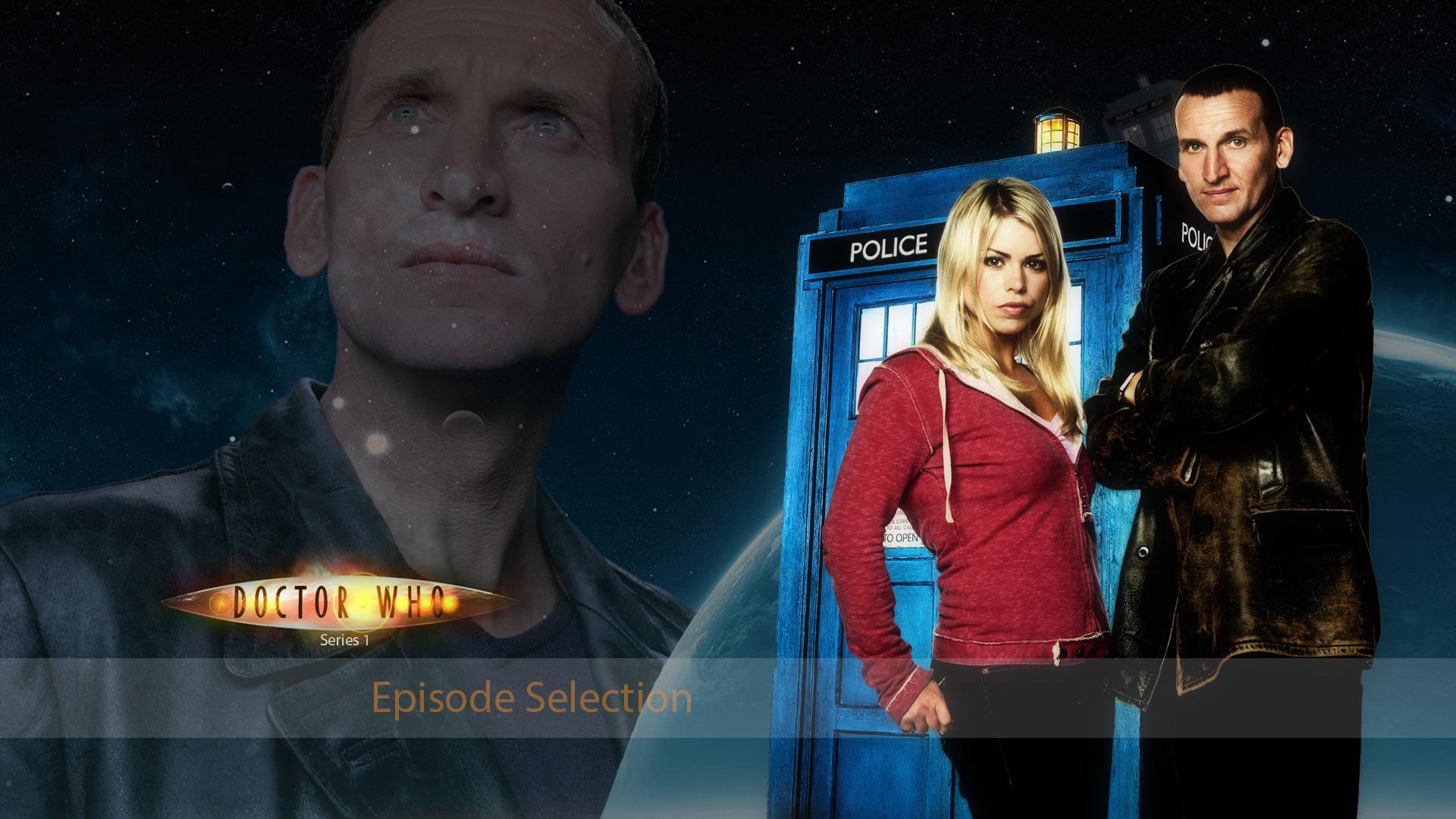

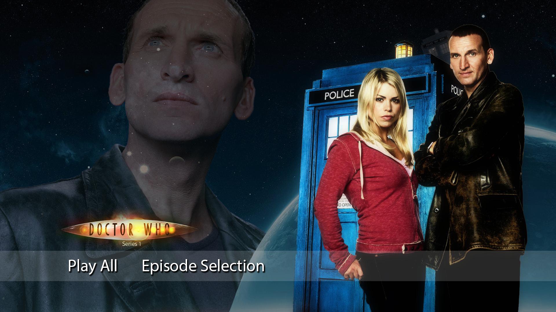

Here's what they actually end up looking like (I couldn't take a screenshot of my Blu-ray player, so I had to fake the appearance using photoshop, but they look just like this on the player itself)
On the first page of the menu, the text links are invisible, but their subpictures still show up. On the second page, almost everything is perfect, except the box around the episode list doesn't show up. Another problem I had was when I included background music for the menu, Encore would crash attempting to render the menu. I solved this removing the music, but I'd really like it to be there if possible, as the music supposedly can play uninterrupted even when the user opens the episode selection box with this menu format.
Does anybody have any idea what's going on? The links on both pages have exactly the same properties set, so I don't understand why it's doing this.

I actually figured out how to fix the menu display issues. I was able to correct the issues on page 1 of the menu by rearranging the layers. I was able to fix the issues with the second page by cutting up the box behind the episode list into pieces, and placing the different pieces behind the buttons for each episode. Here is the photoshop file of the fixed menu, which you can compare to the above example for what I changed:

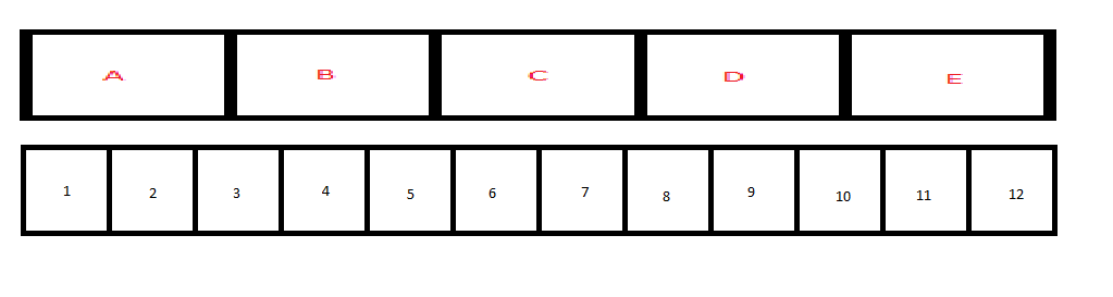

Absolutely. I wanted to display the content at its native 25 fps as best as I could on a 60Hz display. There are currently a few ways to do that, and I am unhappy with the end result of any of them. Currently the best ways to display 25fps on a 60Hz display are:
1. Slow down the frame rate. This is simply unacceptable for me. It creates a noticeable difference in the actors' voices.
2. Pulldown (2:2:3:2:3). This keeps the frame rate the same, but introduces a lot of noticeable frame jitter.
3. Frame blend. The typical frame blend causes way too much motion blur and nearly every frame is a partial blend between two frame. While this keeps the framerate smooth, with no jitter, but looks too smeary. Here's an example of typical frame blend:
Frames A-E are the 25 fps source
Frames 1-12 are the 60fps output
Each 60fps frame in a frame blended output will look like this:
1: 58% A + 42% B
2: 17% A + 83% B
3: 75% B + 25% C
4: 33% B + 67% C
5: 92% C + 8% D
6: 50% C + 50% D
7: 8% C + 92% D
8: 67% D + 33% E
9: 25% D + 75% E
10: 83% E + 17% F
11: 42% E + 58% F
12: 100% F
Only 1/12 of those frames is 100% of one of the source frames, and each pair of source frames is blended multiple times. Completely unnecessary. Each pair should only be needed to blend once. By using changefps(75), I duplicate the source frames to a frame rate above the output rate, which means each pair of source frames will only be blended once, and there will be many more output frames which are 100% of a source frame. Here is what a frame blend to 60fps looks like after first duplicating frames from 25fps to 75fps:
1: 100% A
2: 100% A
3: 40% A + 60% B
4: 100% B
5: 80% B + 20% C
6: 100% C
7: 100% C
8: 20% C + 80% D
9: 100% D
10: 60% D + 40% E
11: 100% E
12: 100% E
Look at that. 8/12 frames which are 100% identical to source frames. only 4 frames needed a blend. This produces the same fluid movement as a traditional frame blend, but it provides substantially better clarity. Watching a video with this method looks almost identical to watching a 25fps source on a 50Hz screen.
First of all, my content isn't 50i, it's 25p (filmed in the UK @ 25fps). Second of all, I already mentioned that a PAL to NTSC slowdown is entirely unacceptable to me. Not only that, but my method produces a smoother image than a typical 3:2 pulldown on a 60Hz TV as well.
