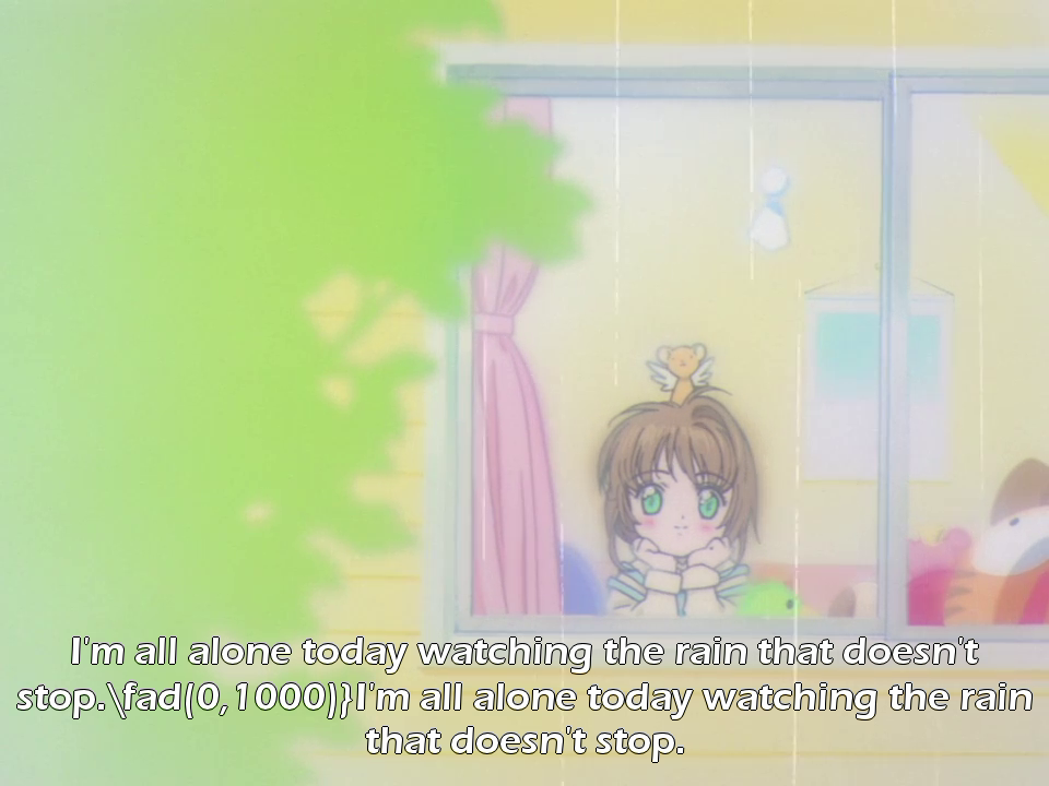

    Handbrake doesn't seem to have a problem with converting these for the most part... But it does have one problem: the subtitles. And after opening up SMPlayer, I can see why.
    There's the opening and closing. Notice how half of the top line is either rainbow-colored, or faded out? That's because the people who made these videos were able to make the subtitles all fancy for lyrics, letting the colors of certain words change as they were sung (as in the opening), or actually moving and fading out (in the ending, any words that are sung actually move to the left a little and fade out).
    Handbrake can convert these, but it can't get the subtitles quite right.
    On one hand, the subtitles ARE soft-subbed, and I can turn them on or off in VLC. The bad news is that they're all glitched up.
    Also, despite being soft-subbed, they're done in a way that the PS3 can't seem to detect them. The PS3 can PLAY this file thanks to Handbrake's conversion... But it can't activate the subtitles. It doesn't think there are any. (They'd be all glitched up anyway, as you can see.)

    I had an idea that maybe Handbrake can apply an external subtitle file to a video conversion. Maybe I could extract the subtitles from this video file, and remove all the coding for those fancy subtitles. (Take a look at the glitchy subtitles from the VLC playback. Looks like there's some coding that causes those fancy subtitles. Maybe I could get rid of that.) However, there'd still be the problem of the subtitles not showing up on the PS3. So does anyone have any ideas? I wanna be able to play these on the PS3, with soft-subs.

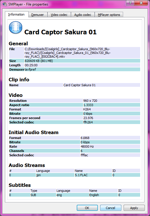

    AVCHD cannot be cropped. So 720p has to be 1280x720 and 1080p has to be 1920x1080
    You have cropped 720p video.
    So if you want to make an AVCHD then you have to re-encode the video to make it 1280x720 because right now you have 960x720 and that will NOT work for making an AVCHD. So basically you want to add 160 pixels of black to either side which will make it 1280 in total for the width.

    Well I was able to find the exact same file on the internet. My observations:
    This is a 10-bit video file and although I've heard of such files this is my first download of one. Anyway this could maybe be why you had issues playing it. However I had no issues playing it. I tested with VLC and MPC-HC and it looked and sounded fine either way and yes that included the subtitles. Just so you know I'm running Windows 7 Ultimate 64-Bit.
    As for converting ... both HandBrake and RipBot264 failed. I imagine this has to do with it being a 10-bit video file. However I did get it to convert with XviD4PSP and I created a M2TS with burned in subs and 640kbps 5.1 AC-3 audio. Tested on the PS3 and it worked a treat.
