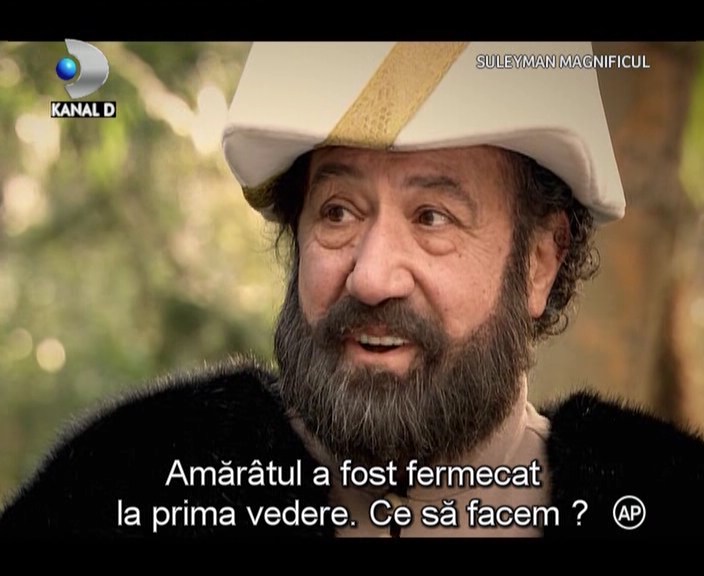

    If your CATV provider is http://digi.tv/ then then best quality advice is to buy a DVB-C tv tuner. Most of them are with USB interface. With a DVB-C tuner is possible to capture unencrypted channels at the quality that the provider sent. You can`t view/record the encpypted channels (HBO, Cinemax, DigiFilm, Discovery pack) because even you buy a DVB-C tuner with CAM and CI the company refuse to pair your device with their card. I have a Terratec H5 and DIGI CATV provider and can I see and record more than 100 digital channels, some are in HD like DigiSport and Nat Geo. Hauppage also have DVB-C tuners.
    The other big CATV provider (UPC / Liberty Global) in Romania encrypt all channel and a DVB-C tuner is useless. Anyway, the CATV provider also send analog signal and the unencrypted channels can be see with a classic tv tuner. Both CATV are also in Hungary and I assume that the policy is the same in your country.

    Any tv tuner will capture from TV out, no DVB-C tuner needed. TV receive unencrypted analog signal. In this way you capture analog signal. The quality depend: how good is signal, the capture tuner, and the capture route. All channel can be recorded.
    DVB-C tuners can do digital capture without any loss of quality. All DVB-C tuners capture the same quality. Only unencrypted channel can see and record and it work only with DIGI CATV provider. Also a DVB-C tuner is more expensive. To check if you channel is free take out the card from cable box. The encrypted channels don`t work without the card.
    Take a look how good is a digital capture:
