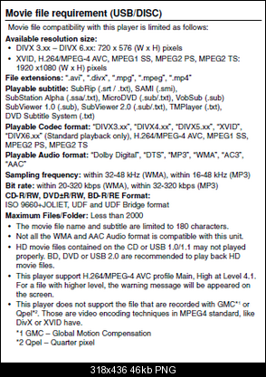

  5. Here is the spec from your manual.
    Your file use a Divx 5 video codec which is only supported to 720x576 so if you want the higher resolution you could re-encode with Handbrake or similar
