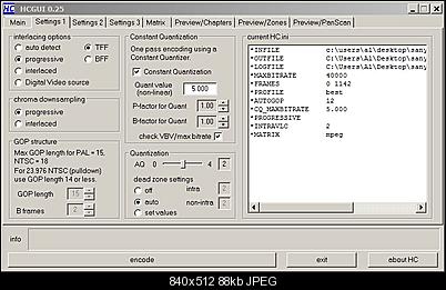

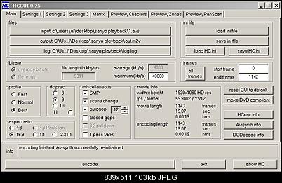

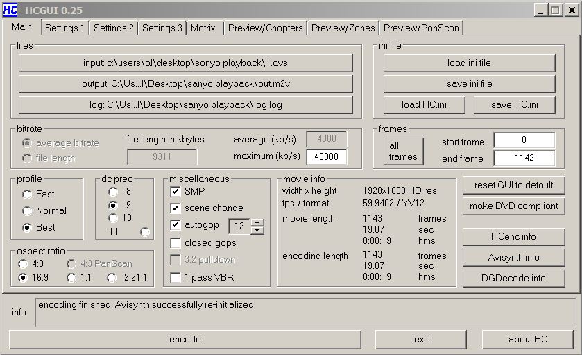

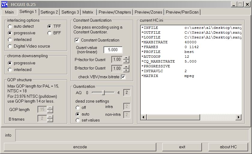

    pics for HCencoder to encode with constant quantizer, progressive video,
Name:	HcEnc pic2 CQ.JPG
