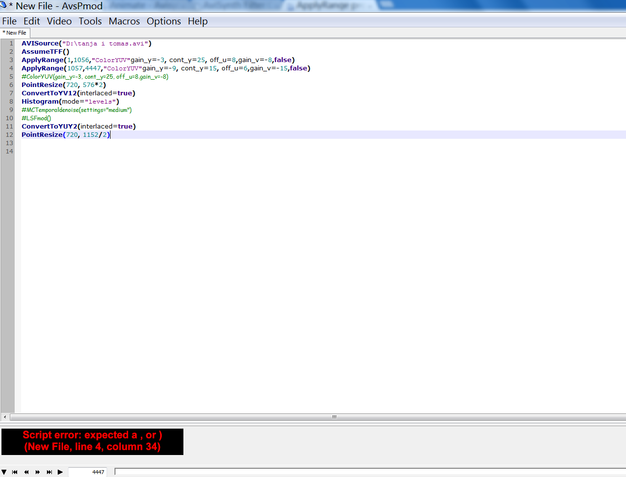

    i tried with applyrange and get error can it be simple explanation

  9. Ok but i get all sorts of error can someone please plain and simple explain the applyrange are the parameters ok in the script above and what should i do to make it work with coloryuv for frames from 1-1056 to 1057-4447 I mean the site of applyrange is very confusing and it should just put plain filter and show how is done ( like mine for example) I mean i don't have to be programmer to understand it I am starting to get tired with avisynth ( and i just scratched the surface of it ) unsimplicity and long learning curve for simple stuff ( because some filter makers even avisynth itself can't make good explanation take for example from Fizick's site how the explanation on the page should be made )

    Anyone? what parameters am I missing or doing wrong I can get applyrange to work with coloryuv in my example and ApplyRange(100,149,"Blur", 1.0) works but how to use coloryuv parameters without error expecting this and that i tried , . " and still nothing

  13. Here is how you use applyrange:
    For ColorYUV(gain_y=-3, cont_y=25, off_u=8,gain_v=-8):
    ApplyRange(100,101,"colorYUV",-3, 0, 0, 25, 0, 8, 0, 0, -8)
    # Coloryuv will apply from frame 100 to 101, replace according to your needs
    # you can use multiple instances
    You have to respect the order of the arguments and put 0 if there is one you don't use, as a reminder the main args below:
    coloryuv(gain_y,off_y,gamma_y,cont_y,gain_u,off_u, gamma_u,cont_u,gain_v,off_v,gamma_v,cont_v ( etc....))
