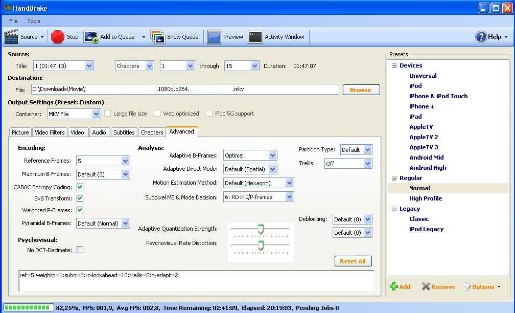

    I am not yet testing options in small excerpts, as was very nicely suggested by Evil_Burrito, but went for the whole thing to see how long it took with Handbrake.
    In fact, when you use 2-pass conversion and better choices quality-wise, things get a lot slower. Around 23 hours as you can see.
    Have a look at the specs I have chosen.

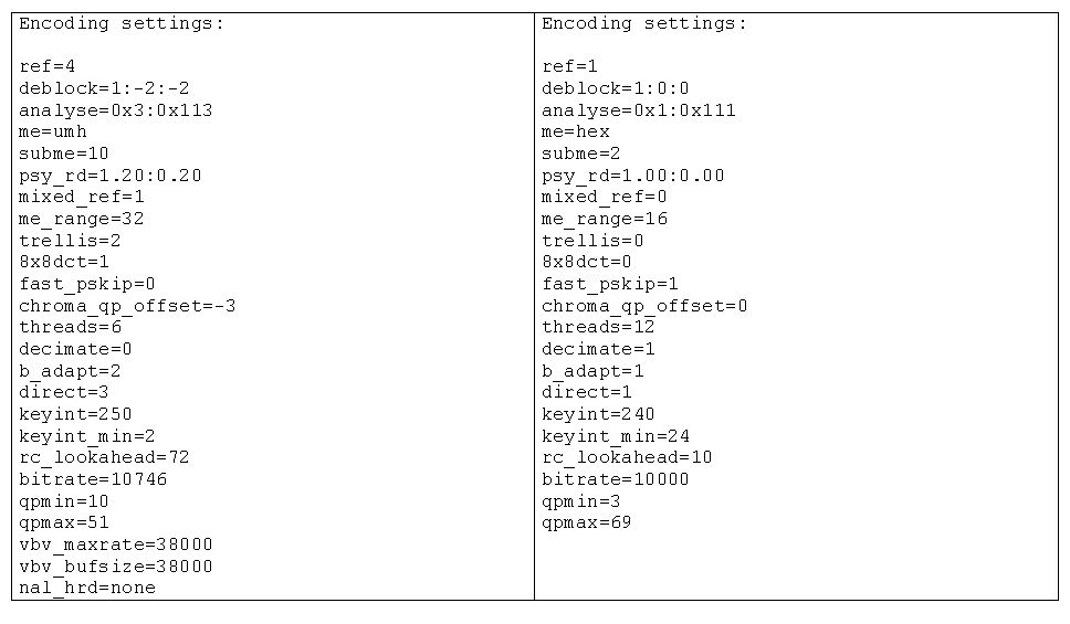

    I'm resurrecting this thread because I have just used Vidcoder to convert another file, with pretty good results I think.
    My main concern, as always, is to be able to fit the 1080p mkv file into an 8Gb size. As you had recommended I used a 2-pass encoding, with turbo first pass. And things went pretty quick, lasting less than an hour.
    But as I know the devil is on the details, I would appreciate for you to see the "small print" data in the Encoding settings.
    Original on the left. Converted on the right.
    Please tell me what values I should pay attention to. Thanks.

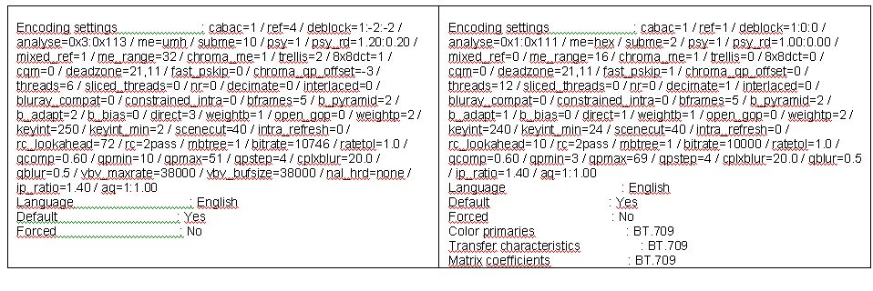

    OK, I am trying to make things easier and encourage some help.
    So I proceeded to put encode settings side by side and eliminate those that were the same.
    Then I ended up with the list below. If you can't help me can you suggest where could I go get some help?
    Of course, what I aspire to would be to have the same specs of the original (on the left) when I convert it (on the right).
    That may involve additional conversion time, so it would help to understand what is what.

  6. Member Evil_Burrito's Avatar
    Jun 2012
    I am not really sure what the question is, but what I see is: those are "loose" (quick) settings. Unless you have a slow old single core cpu, I would raise several of those settings. 1='ref'erence frame works, but more (5 for film and 10 with anime) will compress a little more efficient. Deblock=0 is standard/good, but -1:-1 is slightly better for film. me=hex (motion estimation=hexagonal) is okay [for standard resolution], but high resolution (1080) video has more pixels, thus should get more analysis; typically use umh "uneven-multi-hexagonal" with decent subme like 7-9 (10 is basically overkill and is slow slow).
    If you don't understand a setting look on this page for definitions.
    http://mewiki.project357.com/wiki/X264_Settings
    What is stopping you from using the same encode settings as the original? btw, there is a program that can extract x264 settings for reuse (or just copy/paste).
    Having lots of memory is good and all, but vidcoder doesn't need and won't use 8 gigs. It is likely to utilize less than 2gb even with 1080. Excluding filter operations, it simply doesn't need large amounts of memory.
