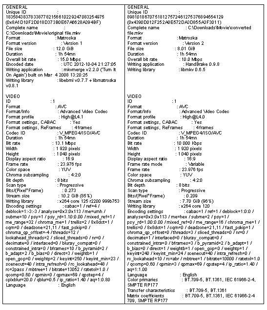

    This is the Mediainfo comparison between the files.

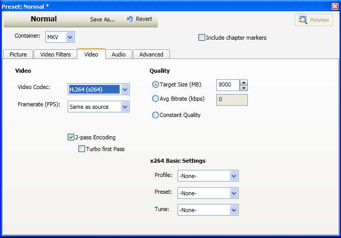

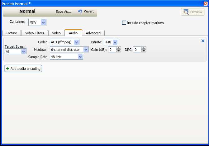

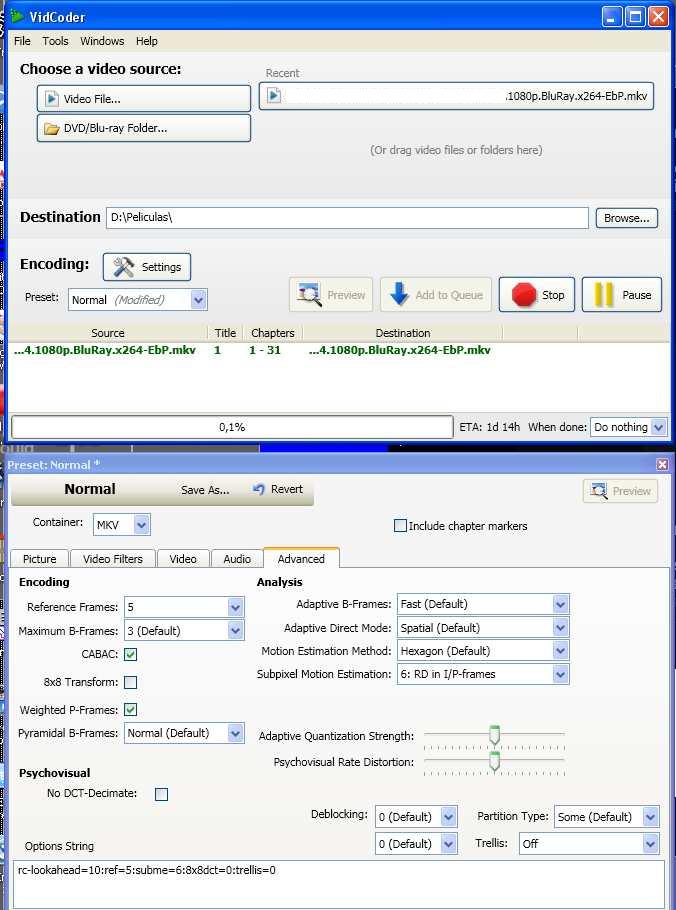

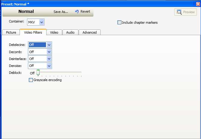

    Ok, I captured some Vidcoder screens simulating a conversion.
    During the time I took to capture the screens, the expected conversion time got to 2 days and 4 hours, and still growing.
    With Handbrake I did this very same conversion in less than 5 hours, with no 2-pass though.

  28. In vidcoder, you didn't checkmark "turbo first pass" (under the 2pass checkbox)
    In handbrake, (if post #15 was the mediainfo report) you used faster settings eg. 1 ref frame vs 5 ref frame, subme 2 vs subme 6, and 1pass abr vs. 2pass (with slow 1st pass)
    If you like handbrake , then use handbrake. If you want same results, you need to use identical settings

    I am trying to understand what each item means, what should I use on each program and why. It's certainly not a question of programs.
    About Reframes, if I'm not wrong I used 4 frames, not 1. I don't know what Subme is: where is it set as 6 on Vidcoder?
    And I'm aware that I didn't use 2-pass or turbo on Handbrake. That's the next thing I will try.
    post 15, the 2nd screenshot says 1
    Short version: the actual encoding settings say 1, but the mediainfo report says 4. The difference is mediainfo reports the DPB size, not the number of reference frames
    1) use of b-frames introduces 1 ref regardless of # of b-frames
    2) use of b-pyramid introduces 2 refs
    1+1+2 = 4
    subpixel motion estimation
    http://mewiki.project357.com/wiki/X264_Settings#subme
