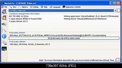

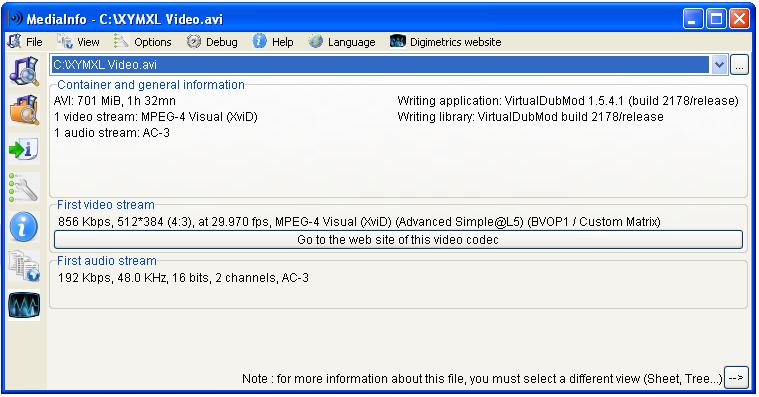

    More INFO on the video file using MediaInfo:
