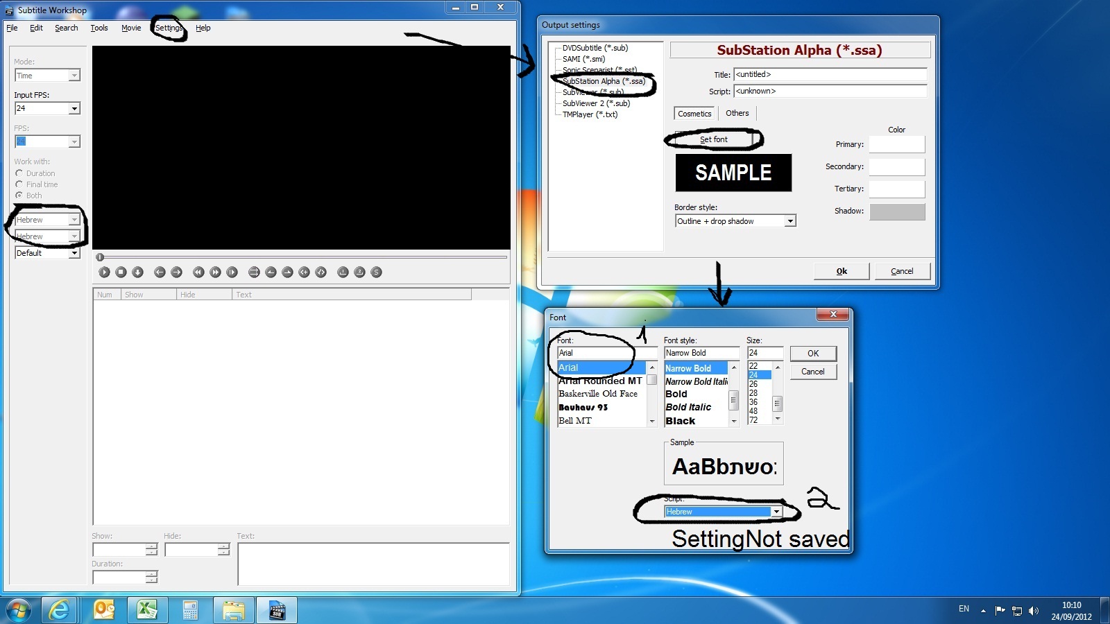

    I thing there is a bug in HEBREW setting support in that tool. A SSA option for Arial/Hebrew setting is not saved.
    DO:
    In "Subtitle Workshop" -> Settings -> output settings -> SubStation Alpha (*.ssa) -> set font -> Script -> select Font:"Arial", Select Script:"Hebrew" -> OK -> OK
    Verify:
    Return back to main screen after the saving...
    In "Subtitle Workshop" -> Settings -> output settings -> SubStation Alpha (*.ssa) -> set font -> Script is still "Western". The :"SubStation Alpha (*.ssa)"+"Arial"+"Hebrew" combination was not saved.
    Any Idea ??

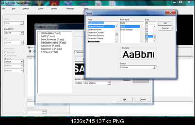

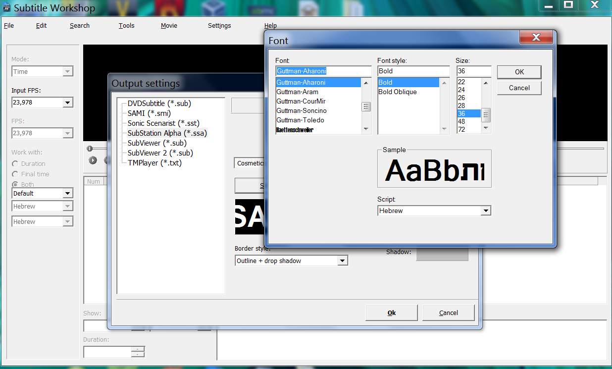

    Of course I check after save:
    Try different font
    Try select Subtitle Workshop Run as administrator

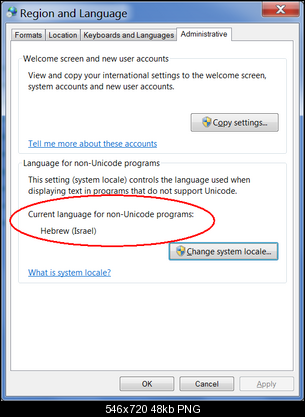

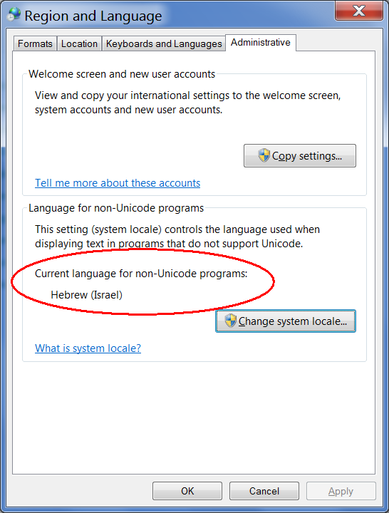

    Check OS Configuration set to hebrew:

    If I select your suggested full settings: Guttmmn Aharoni - Bold - 36 - Hebrew ... I succeed to save them!!!

    If I select (In my case) : Arial - Narrow Bold - 24 - Hebrew... No success !!!

    Check OS Configuration set to hebrew - checked.
    As for:
    Subtitle Workshop Run as administrator - Still same problem.
    I not check with Arial in first time
    for Arial it also for me not saved.
