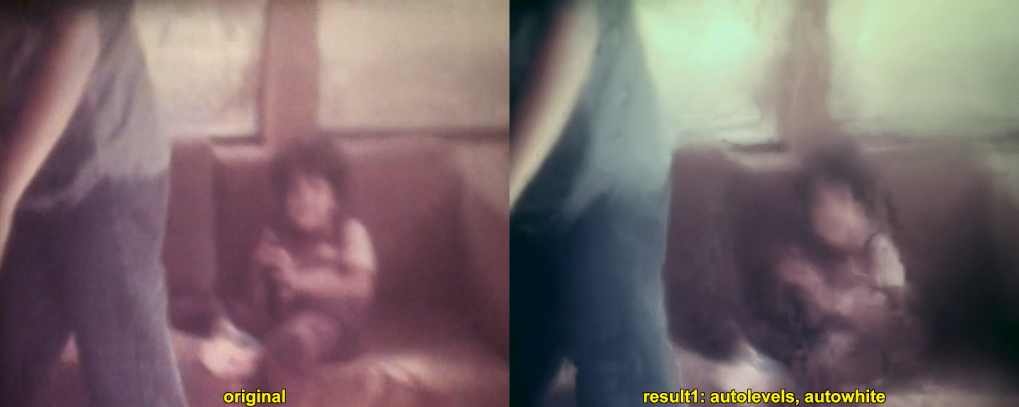

    Dear Fred, first of all the color has improved dramatically but some results end like this. Please advise. Thank you.

    Feb 2011
    Gent, Flanders, Belgium, Europe, Earth, Universe
    Hi Robert,
    What source is this? My script is not made for video!
    You do not need my script just to change the colors.
    ColorYUV(autowhite=true) is enough here.
    Anyhow, these artefacts are caused by the interpolation.
    Please use my other script without interpolation.
    Fred.
