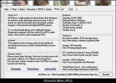

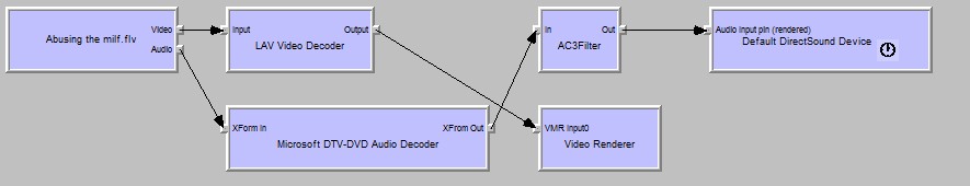

    Just checked mine and mine uses the ac3 filter 1.63 as shown below
Name:	ScreenHunter_135 Sep. 28 23.21.jpg
Name:	ScreenHunter_134 Sep. 28 23.21.jpg
    I actually downloaded the AC3 1.63 filter and installed separate. Might try that one if you don't want to try AVISynth method.
